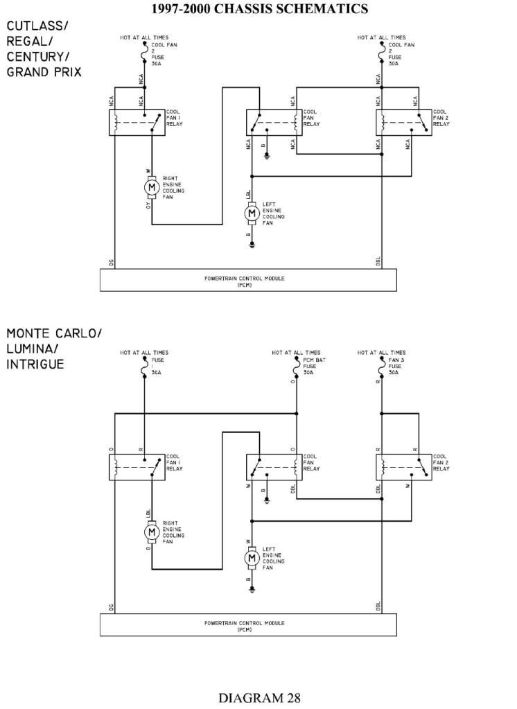

Hi everyone,
I have a 1997 pontiac grand prix with a 3.8 engine. I have noticed that the cooling fans do not turn on. I have checked fuses, relays, replaced the temp sensor by the thermostat. I have also put 12v power to the fans and they both run. I don't know where to go from here, I do know that only one of the four wires going to the fans checks out to a ground, not sure if the other three are all power wires ro if i have a bad ground there.
