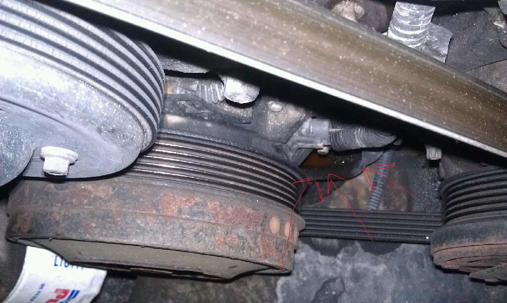

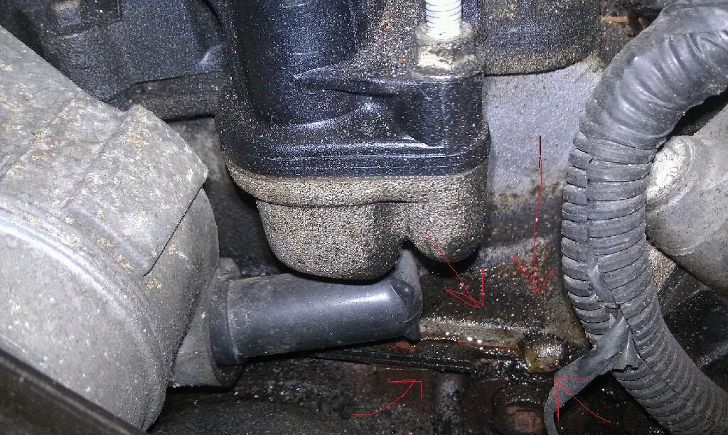

    OK, so ive been leaking coolant very slowlyy. I think it from the water pump because its puddling underneith the water pump. How do i know if it is actually coming from there. The part is only 35 dollars and the gasket is only 5 or so. Can i do this myself without it being a big deal, if not how much would it be to have someone do it?
    Its Leaking here.. Maybe coolant elbows?
    Its puddling here..

    get under the car and look with a flash light, might be coming out the weep hole.
    Its a pretty easy job, just standard hand tools are needed.

    there's a small hole in the bottom of the water pump housing where coolant leaks out to protect the bearings inside the pump when the seals start to go bad. best way to diagnose is to pressure test the cooling system. autozone or other parts stores should have a tool to rent. pressurize the system to 12-15 psi and see where it's coming out
    edit: the first picture is above the water pump. most likely coolant elbows or the intake gasket, both are fairly common when talking about 3800's

    If it was the intake gasket, wouldnt it be buring the coolan? i think ill start with the coolant elbows

    Intake gasket can only seep oil at the end where you took the picture. If you are leaking coolant, it should be either an elbow or the water pump.

    changed elbows, no leak!

    definetly lol. My water pump didnt have any play at all so i was happy. lol. although, when i took the elbow bt the intake off the rubber hose was gone off the elbow. I think its in my intake somewhere? is this bad or no lol
  13. #13 Re: Coolant Leak?!?
    Troy OH
    2,919
    hmmm... well that's either why it was leaking, or it got left behind when you took the elbow out. it wouldn't have gone into the intake, or rather the cooling passage.

    This is EXACTLY what mine looked like. Little wetness near the elbows, nothing dramatic but I had it puddling in the EXACT same spot as your second picture. I just replaced my Water pump and elbows (aluminum dorman ones). Hopefully this fixes my problem because I can't find a leak anywhere else.
