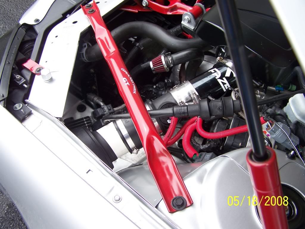

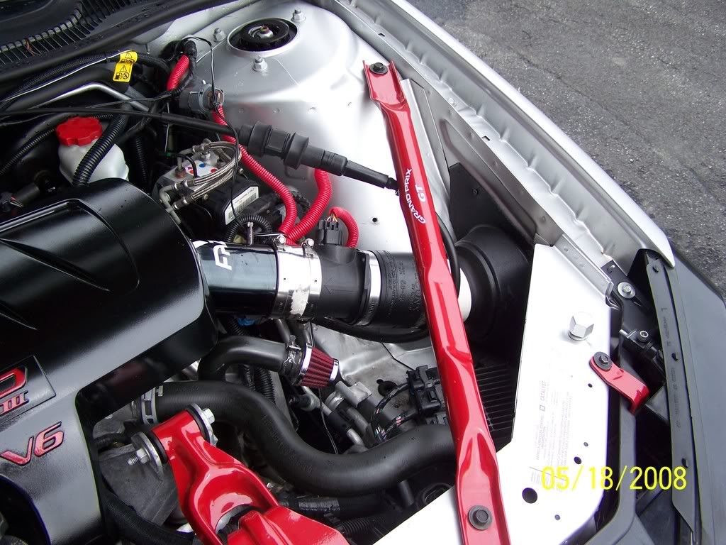

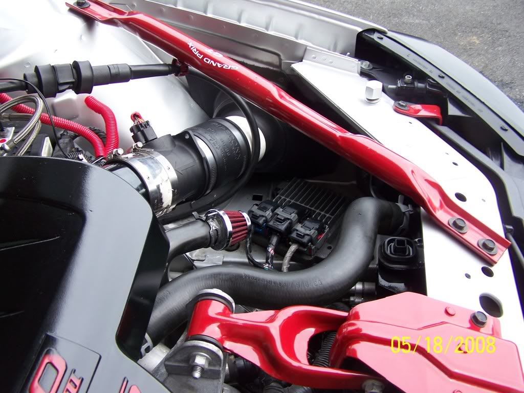

    Try this it was easy to do...

    I was thinking the same thing...what did you use to secure the pcm? I'm doing mine right now, and all I got are zip ties...thinking of going back down there with some sheet metal and some screws, cuz even though I'm sure the zips will hold...it just doesn't seem right.

    wtf is that little breather you have?
    Part of the egr/cold start crap I beleive its calif. emissions

    Quote Originally Posted by DesQ27 View Post
    I secured mine with black zip ties and it has held for a while now with no movement, had sheetmetal screws and they broke. The wire harness holds most of the pressure because it is pretty stiff.

    what size pipe fits the throttle body and mass air flow sensor? I was planning on doing the same set up, Just need the sizes. thanks so much for this post excellent job on that set up. also what size filter did you use?

    I now have the wizaird set up but i believe the pvc was 3" and the filter was 7" long

    why did you get the wizard? did this setup not work out? so the mass flow sensor is 3" was the throttle body connect also 3"?

    Also could you tell me where did you get that mount that is connected to your fender wall. I dont even know what to call it. is that a adapter?
