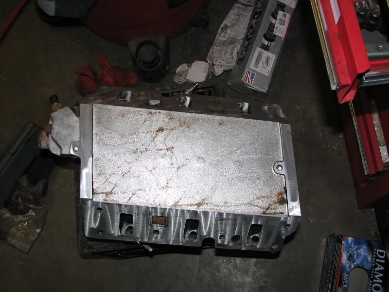

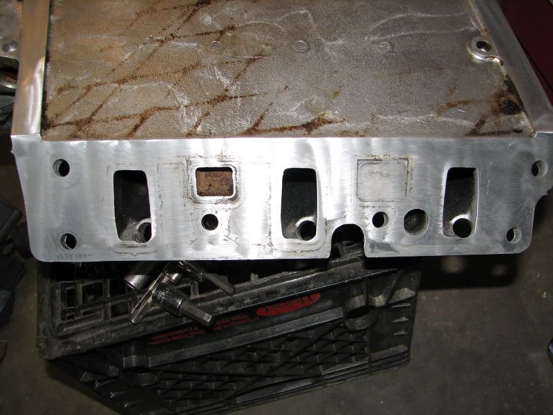

    Hi Guys,
    I'm planning my engine swap and I was looking through some information and pictures and I came up with a question. I will be using the L32 and then when I am ready to overhaul the engine for the turbo, one of the mods is an L32 to L26 intake conversion so that I dont have to use the block off plate.
    My Question Is: On the series 2 engines (at least the non sc), I've noticed that the tb is on the pulley side. I need that... but I will be running an L26 intake and from the pictures I've seen... that isnt possible. Should I just use the L67 instead so that when I swap the intake and run the L36 that is is correct? Or can the L26 intake be switched around to have the tb on the pulley side?
    pics below.
    Thanks

    What vehicle are you planning on doing this in??
    The top picture is in a RWD Camaro/Firebird, whereas the bottom is in a W-Body...
    If you get any W-body L26, L36, L32, or L67, the throttlebody/intake will be on the driver-side of the vehicle, like in the bottom picture.

    you can't really do much about that.
    the UIM only goes on one way and same with the LIM.
    Unless you blocked off the coolant channels and EGR in the LIM .... even then, it'd be custom.
