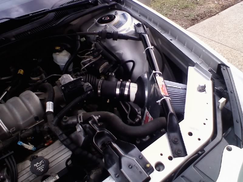

    Quote Originally Posted by vailskier3 View Post
    here's mine
    3" to 4" coupler.
    4" pvc 45* pipe
    4" to 3" coupler.
    maf
    cone.
    drilled a hole for the pcv valve in the 3" to 4" coupler after i had marked where it needed to go.
    batten down the hatches and you're good to go
    That's pretty much what I did except Mine is 22.5 degrees and is 3" on the inside.

  9. #29 Re: Question about 04+ intake.
    Donating Users Durk Diggler's Avatar
    Pittsburgh
    406
    That set up is much nicer that my ghetto homemade k&n style I'm copying that this weekend, keeping my roof flash as a heat shield of course.
