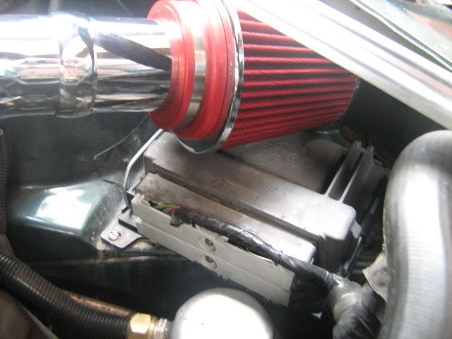

    trust me it will be in the way, your best bet if you really want to go with a PCM tray is goto a local junkyard and pick up a 99 GP tank and relocate it

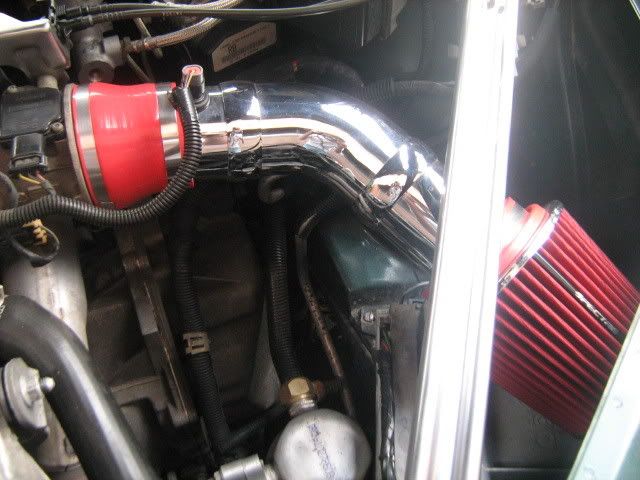

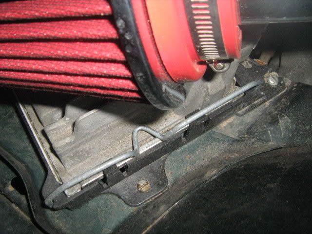

    Yea i just noticed that sabrewings i like that setup a lot how it clips in instead of the zzp bungee tie down thing (hah) Do you think i will be able to make it work without moving my coolant tank??? I know the tanks dont cost much but i am cheap and lazy what can i say....

    That looks awesome.... but doesnt answer my question i sorry to say lol because i have a 97 my coolant tank is in that area and im trying to figure out if that hold down you have will work with or i can modify it so that it will fit there without moving the tank to where yours is now on the passenger side strut tower. But the pictures are great and i appreciate the input!!

    I took some pictures of the homemade tray check out....
