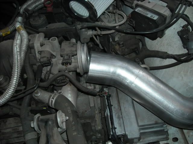

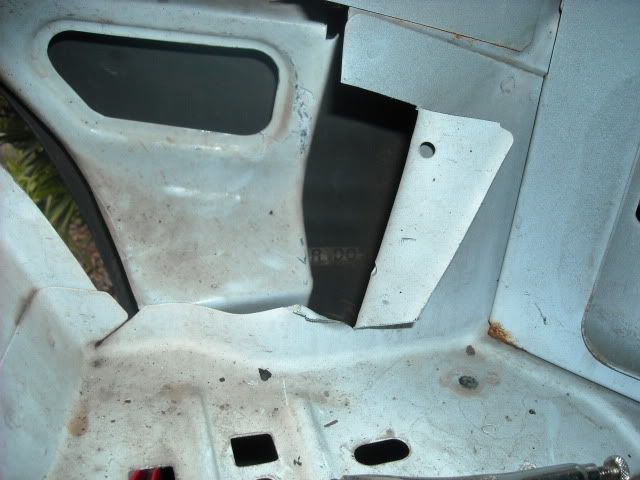

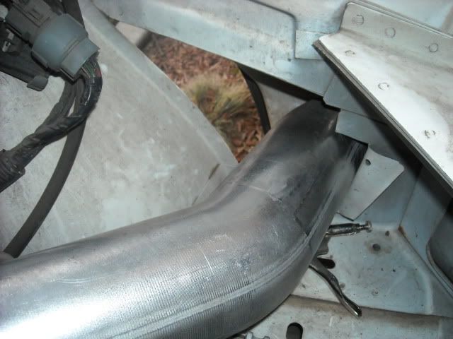

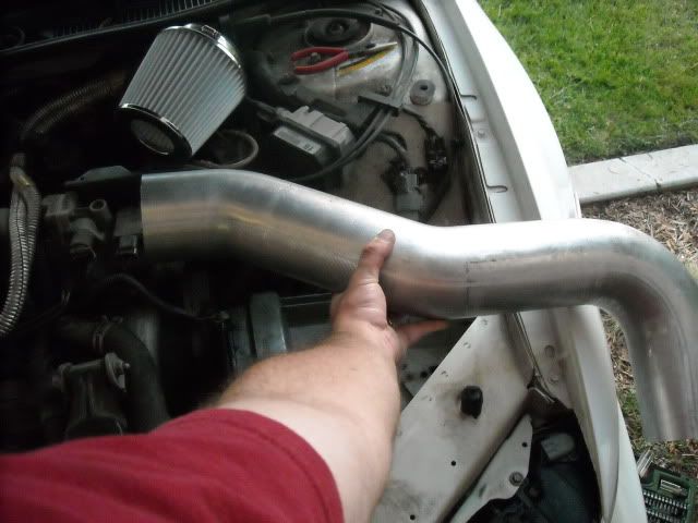

    not sure what is going wrong, but it seems the intake tube is a little long, or a mandrel is at the wrong angle. how much of the inner fender brace do i have to remove? i trimmed some of the bracket where the old air box was that the inner brace bolts to. running out of daylight, and needing some help! i have some pics. i didnt trim any of the inner fender brace, this may correct the strange angle on the intake as well. here it goes
    how much do i have to hack off on the brace? half of it? would like to keep some on the left to keep the fender in right spot...
    seems too long maybe?
    not a problem here really...
    looks at a funky angle..but the brace does need trimmed...just how much?

    I thought that entire bracket in the fender had to be bent completely out of the way?
  3. #3 Re: HELP!!! TDCRacing FWI install...
    Ohio
    1,431
    I believe i cut the whole thing out. It does line up perfectly once you get everything cut the way it needs to be. Also a tip for u on the heat shield he gave u cut a piece of rubber hose ie fuel line or something an put it around the hole otherwise your intake will rattle on that shield

    yeah i did, he is sending me the parts left out. ok, so i have the inner fender brace out...the tube still seems an inch too long. when its at the right angle for the tb it really pushes out the lower fender portion of the bumper. if i set the filter where it would sit normally back there, its at an odd angle on teh tb still. i cut out that brace, still no go...anyone have suggestions or same problems? it seems as if pipe is just one inch too long before the last bend...

    how far in from the end is the hole? mine is still about 2 inches too short. it still seems like it is angled down overall. i trimmed and bent most of that bracket off, and it still seems to hit the fender. maybe the pipe is too long between one of them mandrels? no idea...just checking. so right now, the sensor it just chilling by the coupler sitting there. i know, bad...and it sounds like a bov on my engine..i know bad need to plug the hole if driving...but can someone post a pic of the inner fenderwell to show clearance and fitment of their install? please?? its driving me nucking futs!!

    I cant post a pic for you as its all buttoned up an would be a neusance right now nut like i said u really have to chop the whole bracket out i tried saving part and bending an all kinds of stuff. it really doesnt work u have to cut the whole thing out for it to fit like it should and as far as the wiring i just cut mine and extended it. i have i believe the very first 1 he sold. mine is the one he has pictured in the sale post. i dont think hes made any changes to it so it really should fit just fine

    ok i will bust out the dremel later on when the block off plate gets here, paint it up all nice, and set it up and paint it. yeah, i tried trimming it all down with tin snips...talk about crazy in there. it still sticks out a little bit, like maybe inch, but everything that faced downward on that bracket is gone. its just a little crooked in there now, but it works fine, minus the iat hole. if it was drilled on the other side of where it was, or just a little closer to the tb end it would be awesome, but this thing really sounds mean when you hit it good. growls nicely...can only imagine what it sounds like on a supercharger....oh man..
