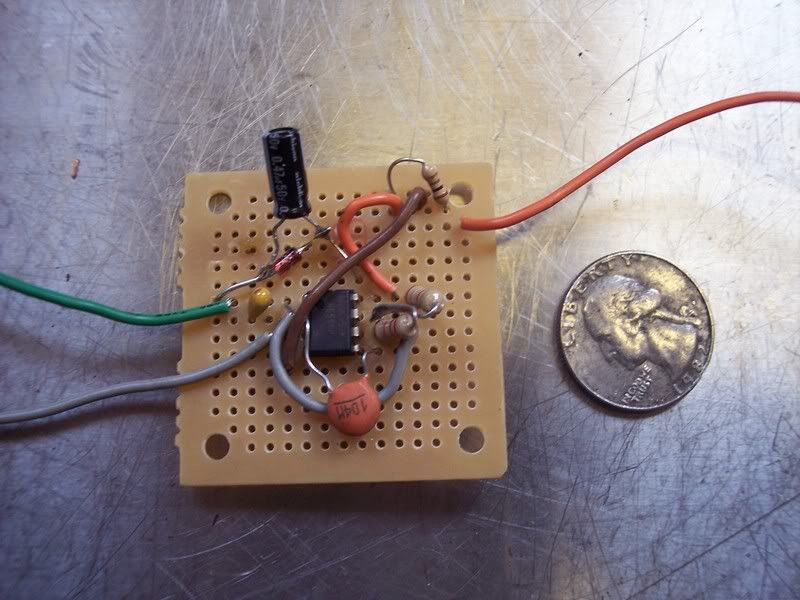

    security light needs to be on during the learn procedure, its always 10minutes x 3 rounds, it may be a different system passlock/passkey/etc
    one thing you can do is on your original PCM, look for a dark blue wire used to go insid ethe car, then go on ebay and get a 30/50 hz ground pulse simulator and wire it up to trigger the passlock (the disable signal is a 30 or 50 hz grouind pulsed signal present only during cranking)
    when the pcm see's it your good to go and it wont kill it.
    the benefit of this is that you can kill the starter power feed to it and have the system enabled as a theft deterent

    Turbocharged400sbc, that is an awesome cheap fix and engineering figuring. I already took the pcm back to the junkyard thinking it might be bad. I am waiting for another one to show up that doesn't have water damage! For some reason 3 are in the yard that have obviously been submerged. Anyways will pick up another pcm try the security relearn procedure again, then move onto the ground pulse simulator. I have most of it already in hand, ingenious idea, that's why I love these forums. Thanks again.
