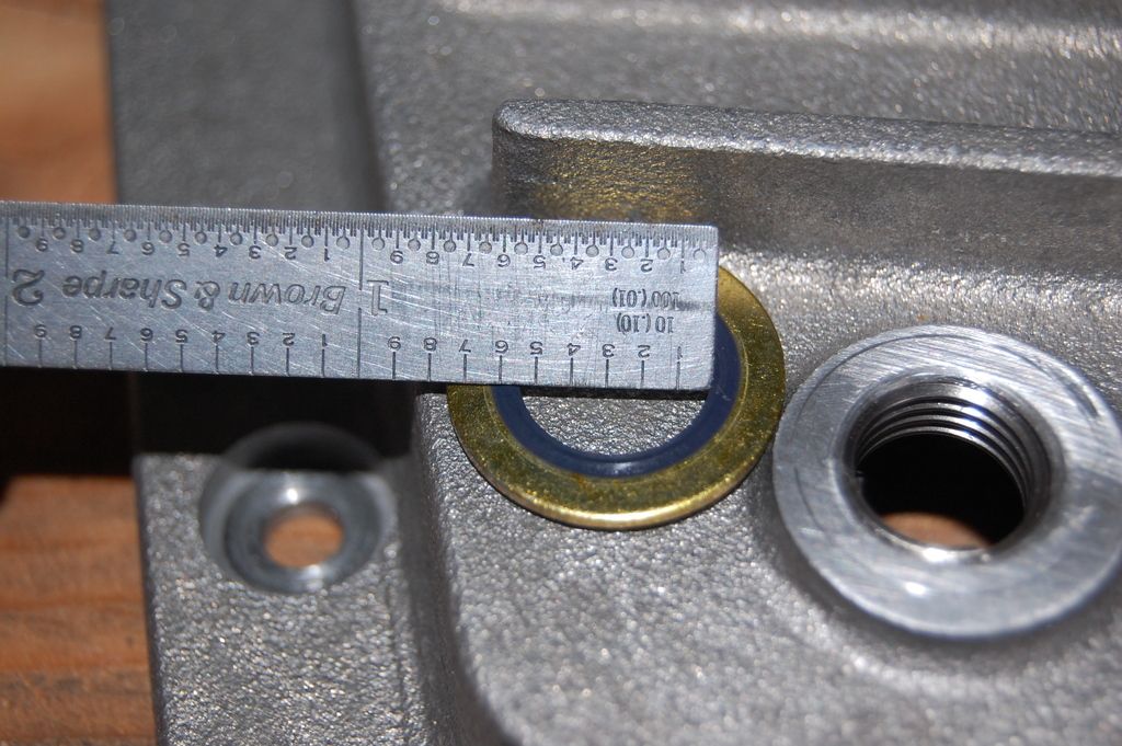

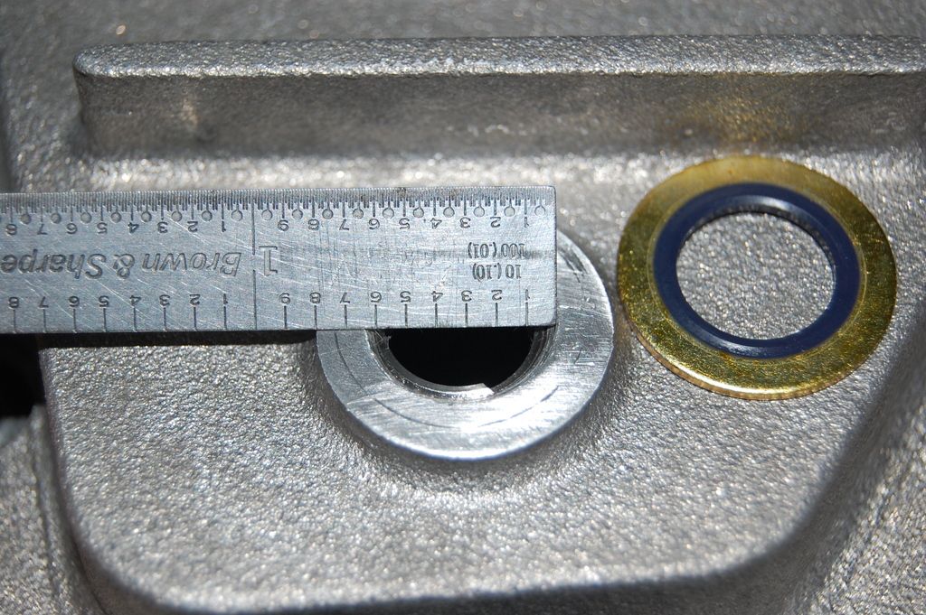

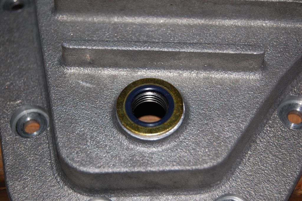

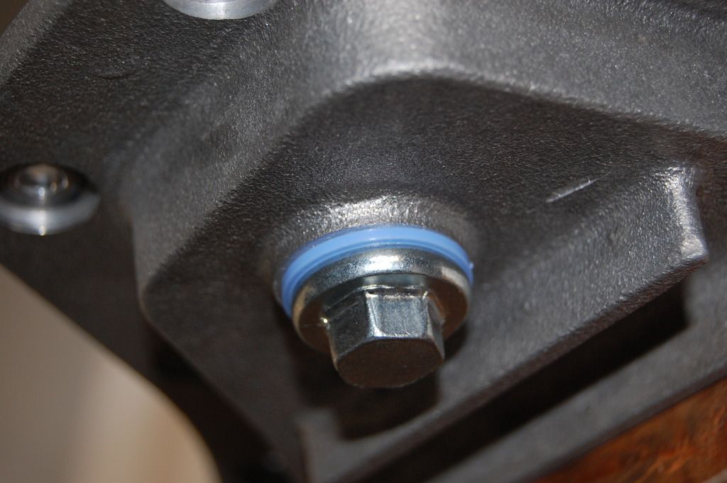

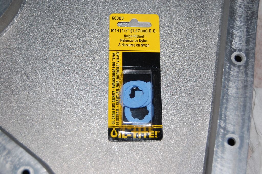

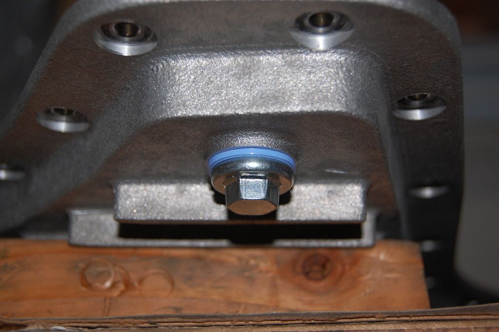

    After got everything cleaned up I did a little measuring. I think I found the problem
    Off to the parts store. These looked promising
    I feel a lot better about this setup. I went to 50 inch pounds, just so I had a point of reference.
    Test #2

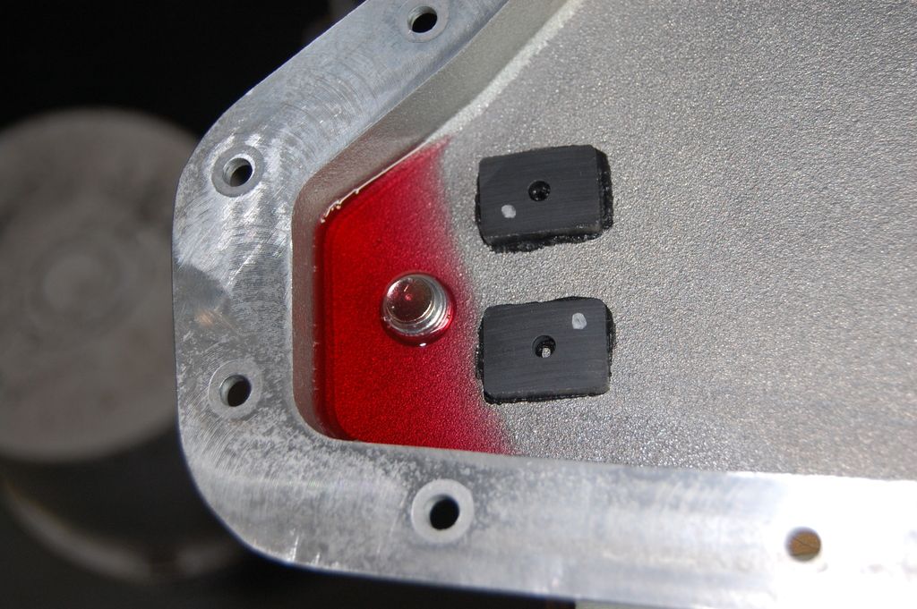

    now drill the end of the plug for a neo magnet or get a magnet equipped plug.
    inspections are quite easy when you can leave the dipstick in, put a shop vac on the case vent, remove the plug and inspect the shavings/accumulation on the magnet and reinstall without loosing a drop of atf.

    It's hard to see due to the similarity in size, but there is a 3/8' x 1/16" neo disk magnet on the tip of the plug. I'll probably dab a bit of RTV on there just to secure it.

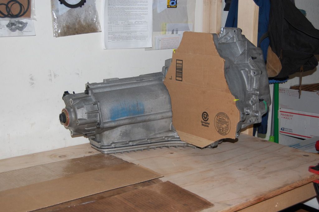

  10. #170 Re: Built 4t65e - Completed
    Mar 2014
    Tucson
    3,190
    10
    146

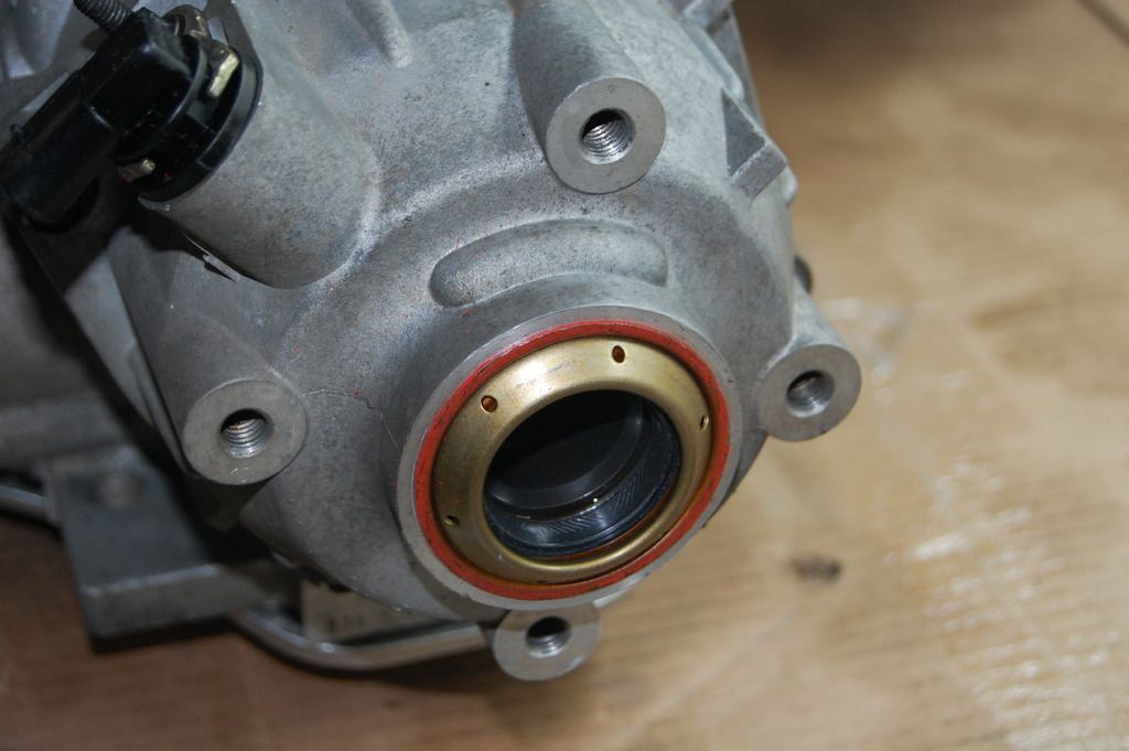

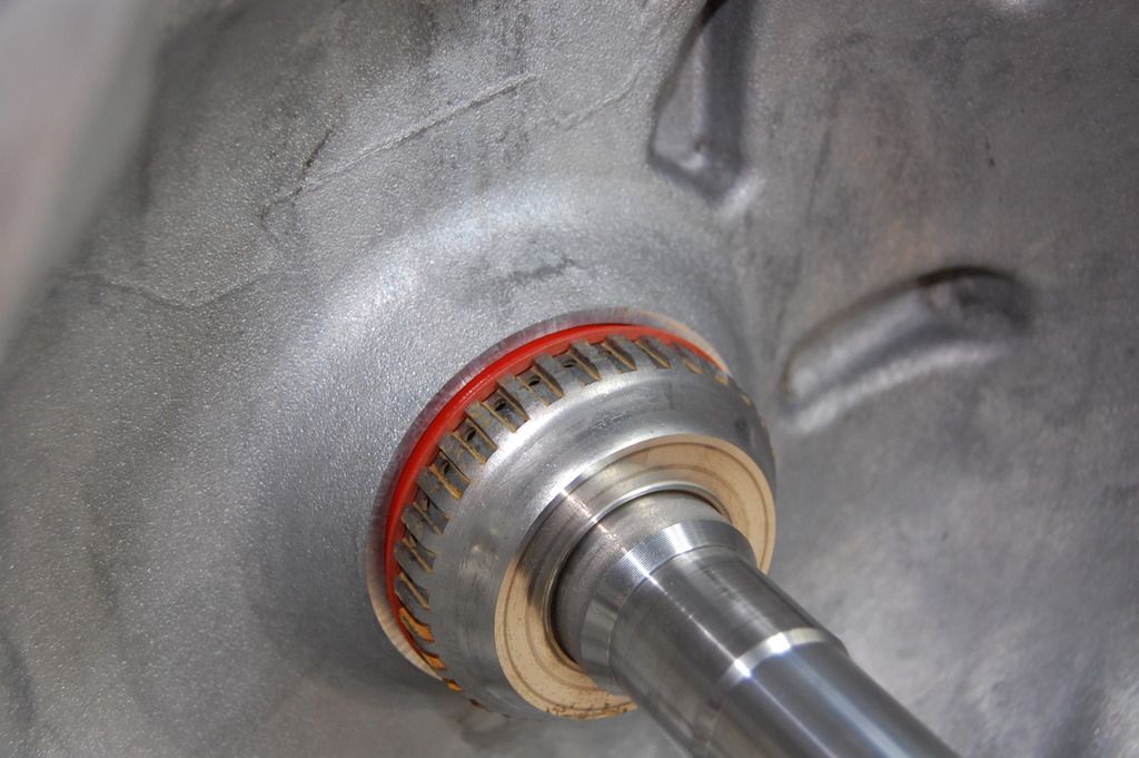

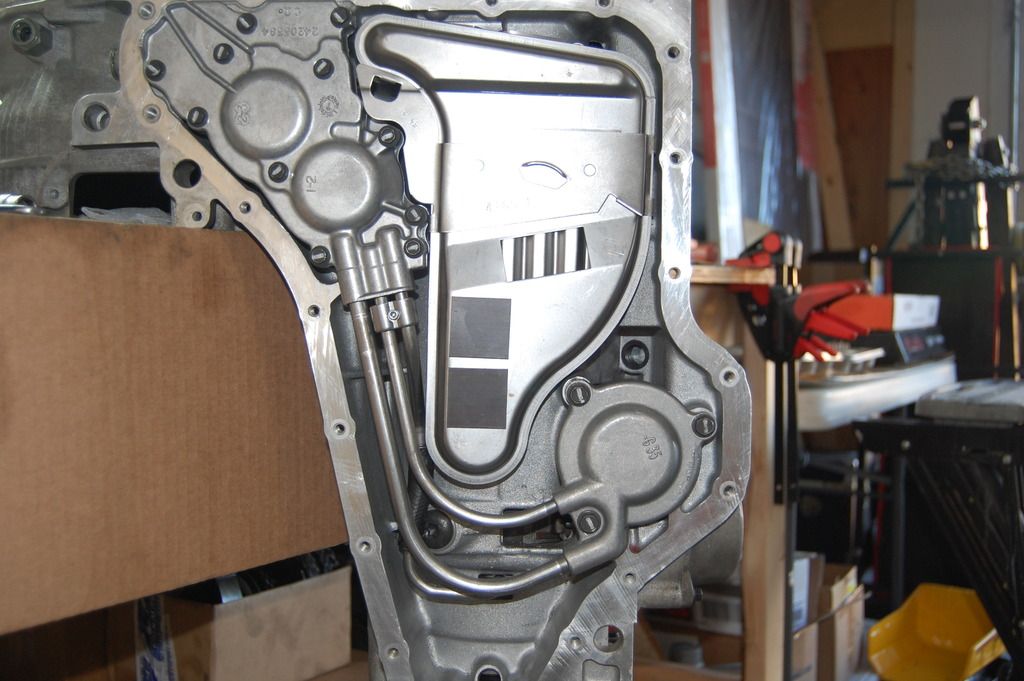

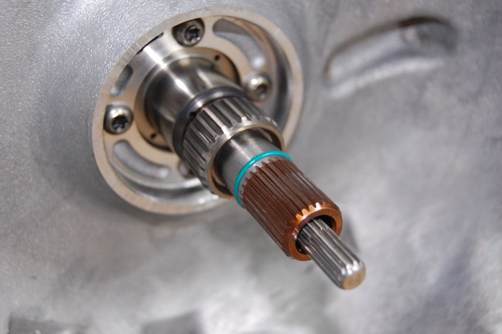

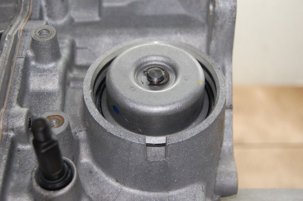

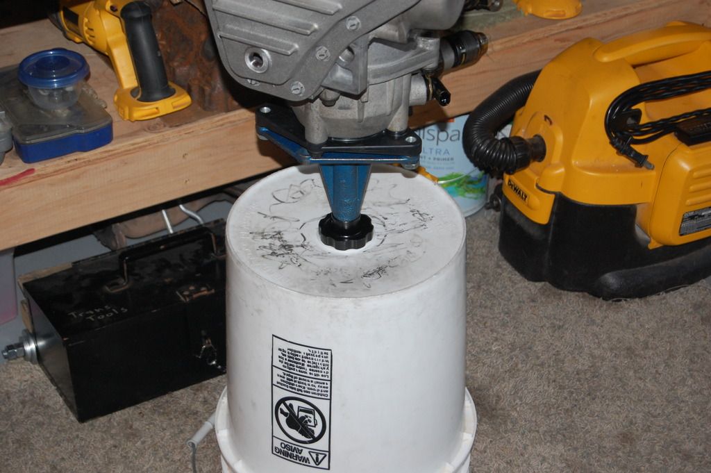

    After sitting all night and most of the day, the plug was still dry. I'm satisfied
    Final flat magnet arrangement before the pan goes on

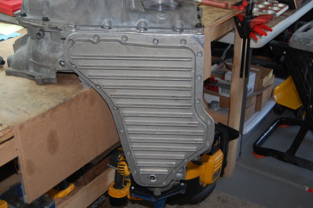

    Pan on and torqued. 80 in lbs for the first round. 120 in lbs final.
    Time to remove it from the bench. I improvised some support while I un-mount it

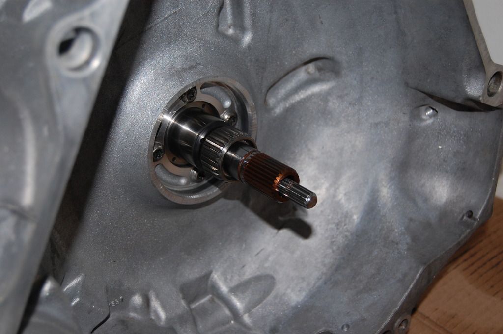

    A little He-Man action and it's up

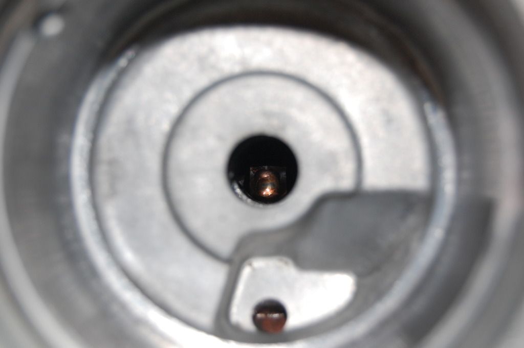

    This is the first opportunity to make sure the pump shaft spins freely. All good there
    Reverse servo is next

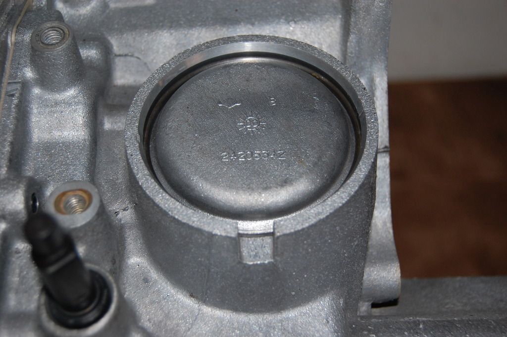

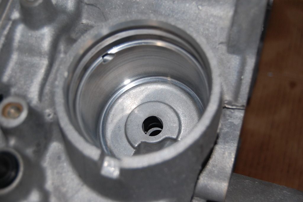

    Check to make sure the band lug will line up. Looks good
    A little lube. Drop the servo in
    Pop the cap on. Had to satisfy the perfectionist in my by making sure the text was straight
    TCC o-ring next

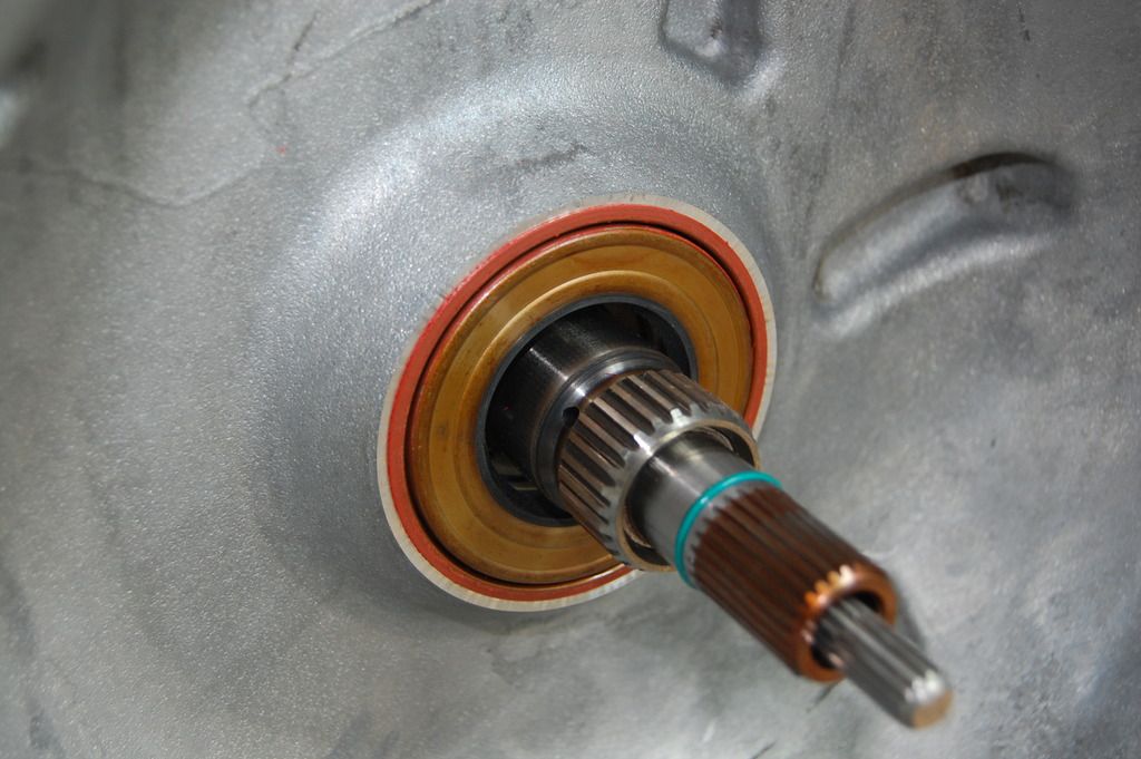

    Install the torque converter seal. Found a good use for the junk 4th clutch hub
    All done here
    Install the right side output shaft seal
    That's it. She's done

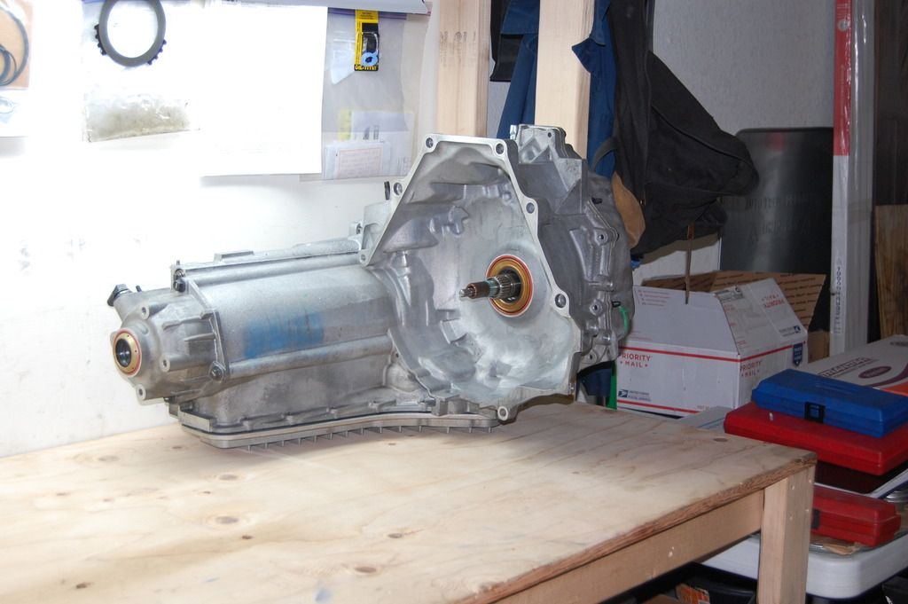

    Made a quick dust cover
    And that's likely where it'll sit till the spring. Just needs a torque converter. I'll grab it locally next time I have a day off.

    i expected that helicoil to give you a problem with leakage, that will leak overtime as the rubber gasket degrades unfortunately. The only real way to fix that permanently is to use a proper threaded insert, you can pick them up on mcmastercarr. Been down this road before with oil pans.

    Well, I hope the HeliCoil does the trick, but I'm going to keep a close eye on it regardless. I feel pretty good about that Nylon washer. Time will tell.
