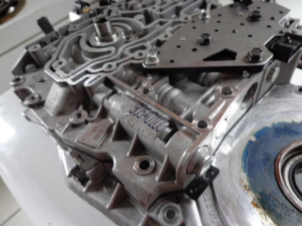

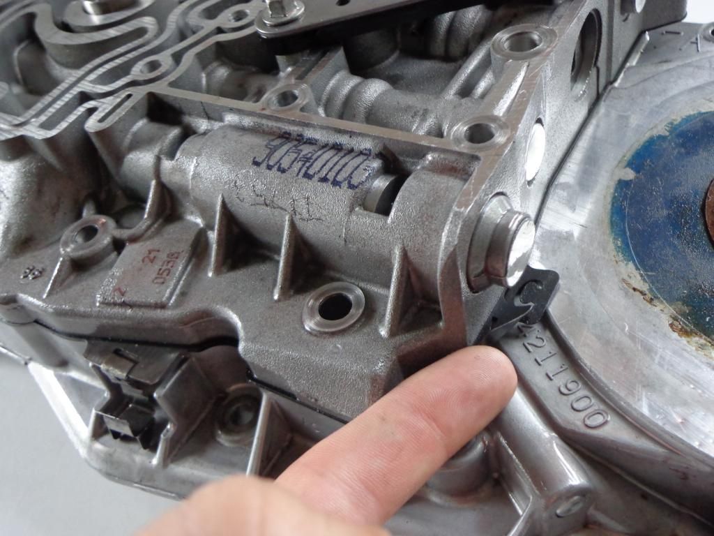

Okay, so valve body came in and I have some questions on it. It has a different looking PCS and TCC PWM solenoid than I do. Same plug from the looks of it, but it looks different. Everything else looks okay from what I can see, just wondering on the solenoids. I know the TCC PWM solenoid I bought was BWD, so should I use it instead?
Here's some pics.
Overall valve body:
http://i14.photobucket.com/albums/a3...ps671c6060.jpg
Solenoids in question:
http://i14.photobucket.com/albums/a3...ps64f8c254.jpg
Various pictures:
http://i14.photobucket.com/albums/a3...ps05e27f95.jpg
http://i14.photobucket.com/albums/a3...psf3b7d0d1.jpg
Valve cover gaskets aren't always brittle, who knew!
http://i14.photobucket.com/albums/a3...psfe21ea97.jpg
Re: TCC repair\freshening up...
They will be fine, they are the "upgraded" ones. Those aren't valve cover gaskets BTW...and your flower fell over.
