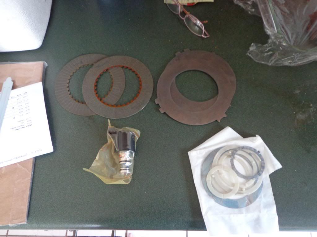

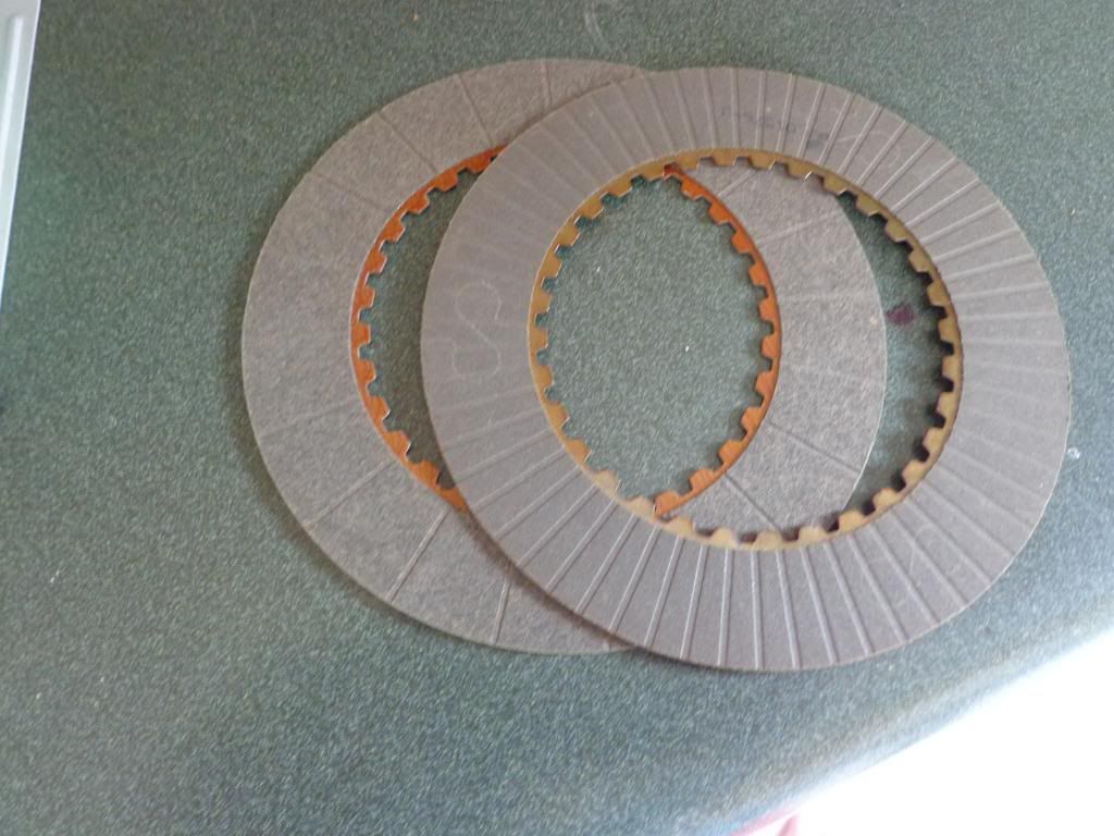

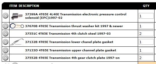

First round of parts got here, still waiting on the 4th shaft. It looks like they sent 2 different kinds of frictions. A Raybestos and something else. Kinda irritating because it's the same part number, I just had a quantity of 2. Can I still use them even though they are different?
http://i14.photobucket.com/albums/a3...psfa28e3a3.jpg
http://i14.photobucket.com/albums/a3...psc1d2480b.jpg

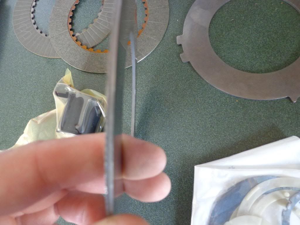

Steels:
http://i14.photobucket.com/albums/a3...ps6de9d9ef.jpg
Re: TCC repair\freshening up...
yes you can... to a degree a friction is a friction.
