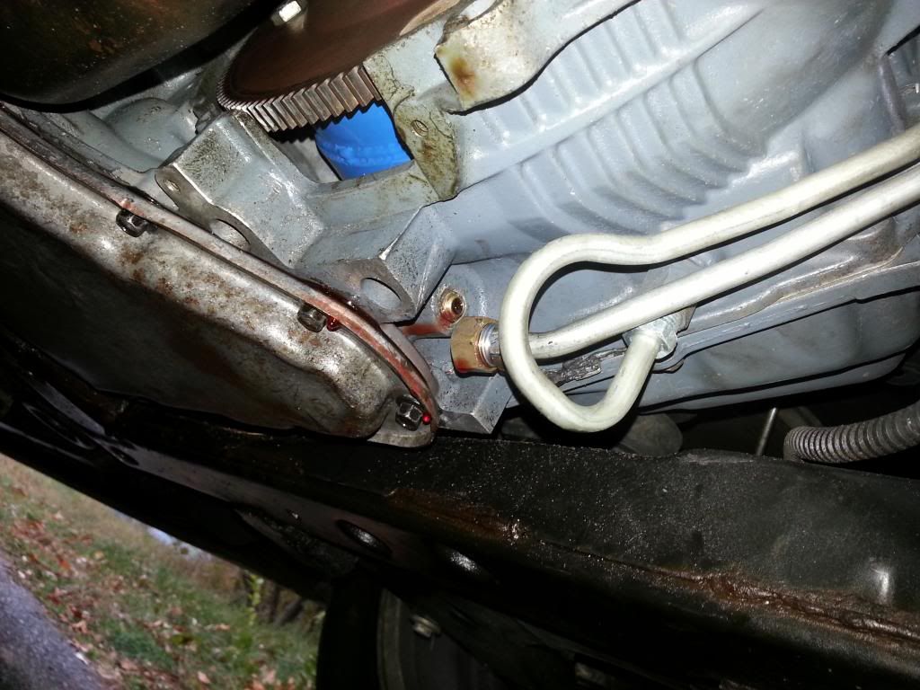

    I leave for FL in 2 weeks and I had a leak so I was going to take off the tranny cooler line and see why the line was leaking. As soon as I started unscrewing it the fitting that goes into the transmision's casing SNAPPED right off. I have this stupid hurricane coming in a few hours and it's supposedly gonna snow right after it and I dont even know where to begin on how to get this damn thing out.
    The tranny is a 1998 verison with the screw in fittings. Taking the trans out is also not an option since I already put in my two weeks in at work and I can't be spending loads of money.

    i would try and cut a slit across and use by big flat head bit.

    Use an easy out. You can pick up the fittings at an advance or such.

    never used one of them before do they really work?

    Yes they really work. Very well actually.

    you were trying to take the line off and it snapped?? either you turned the wrong way and it snapped (ive done it :/) oooor it was stripped in there. I would try what the others said with the easy out

    easy out and a little heat = done in 30 seconds...
