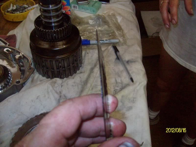

    As suspected, the problem is definitely in the 2nd clutch hub. I don’t know if it’s cracked or not, and don’t really care at this point. I’ll explain my reasoning in a minute. But first, some pics…
    Um, those that are squeamish might want to turn away…
    Something was getting HOT!!!:
    Didn’t have a problem with third, but what rides against the 3rd housing? The 2nd housing:
    Why did the 2nd and 3rd housings get so hot? Well, there’s your problem:
    See where I’m pointing? When I originally air tested the clutches, I heard a lot of air leaking. I never inverted the 2nd clutch by itself while testing. If I would have, as I did today, I would have seen where the leak was. I filled the apply passage with fluid, quickly inverted it, and hit it with 40psi. Fluid blasted out of the space between the 2nd clutch shaft and the driven sprocket support shaft:
    And finally the cause of all of this:
    Do you see it? I didn’t think much of it during the original rebuild. Shame on me.
    Remember what the original problem was…no second gear. Rebuild failure, no second gear. The new clutches were completely destroyed (when the originals were not) because of one little detail. I added an extra steel to the 2nd clutch stack to tighten it up some. I made sure it was within clearance specs as advised by Dave. The extra steel didn’t cause the problem, but consider: Originally, there was a lot of clearance in the 2nd clutch stack; enough, in fact, that the loss of pressure kept the clutches from engaging at all. The new clutch stack was much tighter and was able to partially engage, but slipped like mad making it feel like a mis-shift.
    Of course everything has to be cleaned now and I need some new 2nd clutches along with the hub, but at least I know what went wrong. I just wonder if I should also replace the 3rd hub as well. I think I will, just to be safe.

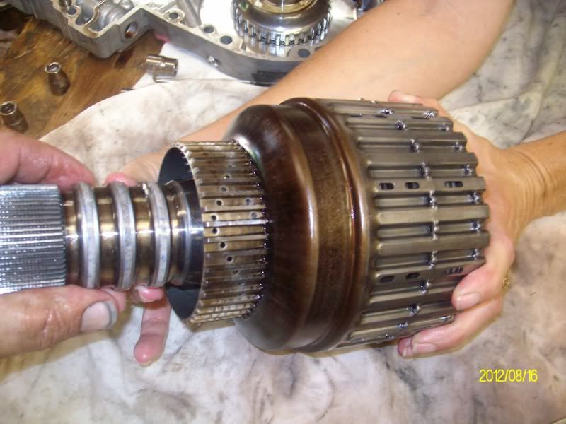

    For those that don't see the problem:
    The arrows are pointing to wear marks inside the 2nd clutch hub. Those wear marks coincide with where the sealing rings ride. Between those seals (indicated by the dots) are the apply holes for 2nd gear. The wear is severe enough to allow substantial leaking.
