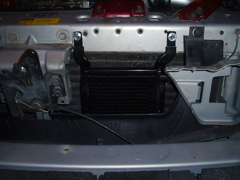

    What brands are you running? Got pics? Curious how you guys are mounting soem of these. I'm really not interested in using those zip tie things through the radiator honestly. Also, are you guys running through the radiator too or directly to the cooler?

    Ive been running the GMPP cooler forever. But I know TurboKent runs a cooler similar to if not one from Trannyman and likes it very much. Ive used the zip tie kind before, however, with great success, they work just as well maybe better than the GMPP kit because you can get them in larger sizes.

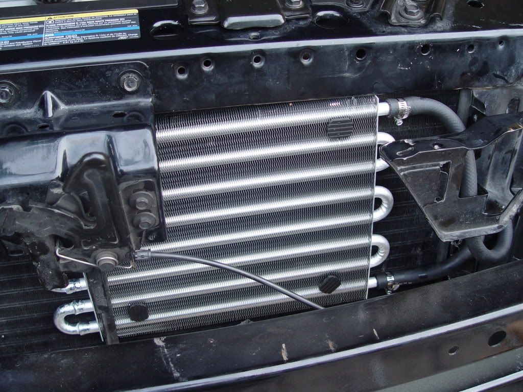

    Hayden Transmission Cooler #1405 for $30 you can't beat it..
    I have some pictures of the install somewhere if you want to see them.

    How did you mount your Hayden Kent? Are you useing the radiator cooler too or JUST the tranny cooler? I''d like to see those pics if there handy. Where did you get yours? Link no worky.

    I dont think you can compare the Hayden and the GMPP coolers to one another as they are different beasts. The GMPP is a stacked plate cooler and the Hayden is a tube and fin cooler (I forgot the technical name). The stacked plate coolers by design will not cut of fluid flow if part of the cooler became blocked for some reason. Though I do not know how they compare in cooling ability, if memory serves me the stacked plates were more efficient but I'll leave room there to recant just in case Im incorrect about that.
    I am using the radiator still or was, I dont plan on doing so once the rebuild is complete, and I plan on changing my cooler set up and going to a set up similar to what Farnsworth is using. I DO NOT recommend putting a cooler on and not going in series with the radiator cooler and putting it after the radiator cooler. You more or less defeat the purpose if you leave the radiator cooler functional and dont put the extra cooler after the radiator.
    If you disable the radiator cooler thats another story, you just need to make sure you use a cooler sufficient enough to keep things in the proper temp range, which for tranny fluid is going to be in the 170* area.
    My tranny fluid temps on the hottest of days here in OK (days when the temps were up over 100) my fluid temps were over 200. Usually around 205 maybe 210 depneding on how hard I was pushing it. It took me maybe an hour to hour and a half to install the GMPP cooler. I went out before I installed it and drove a certain route that took me on city streets and a stretch of highway.
    When I installed the GMPP unit I went back out on the same path to get the fluid temp reading from that. The highest I saw on the pre-test was 205* and it would hit upper 190's to 200 on the highway. When I installed the GMPP cooler my temps had dropped down to mid 180s to mid 190's, with the 190's obviously coming with the city driving and having to stop at the stop lights.
    So I got around a 10 - 15* drop in fluid temps, and given the size of the GMPP cooler, I was happy with that. Tranny fluid over 200* (conventional fluid anyway) starts to break down rather rapidly. So keeping it under that mark was a goal for me but Im going to do more to give myself more of a cushion when the car goes back together.

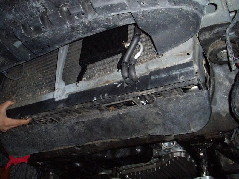

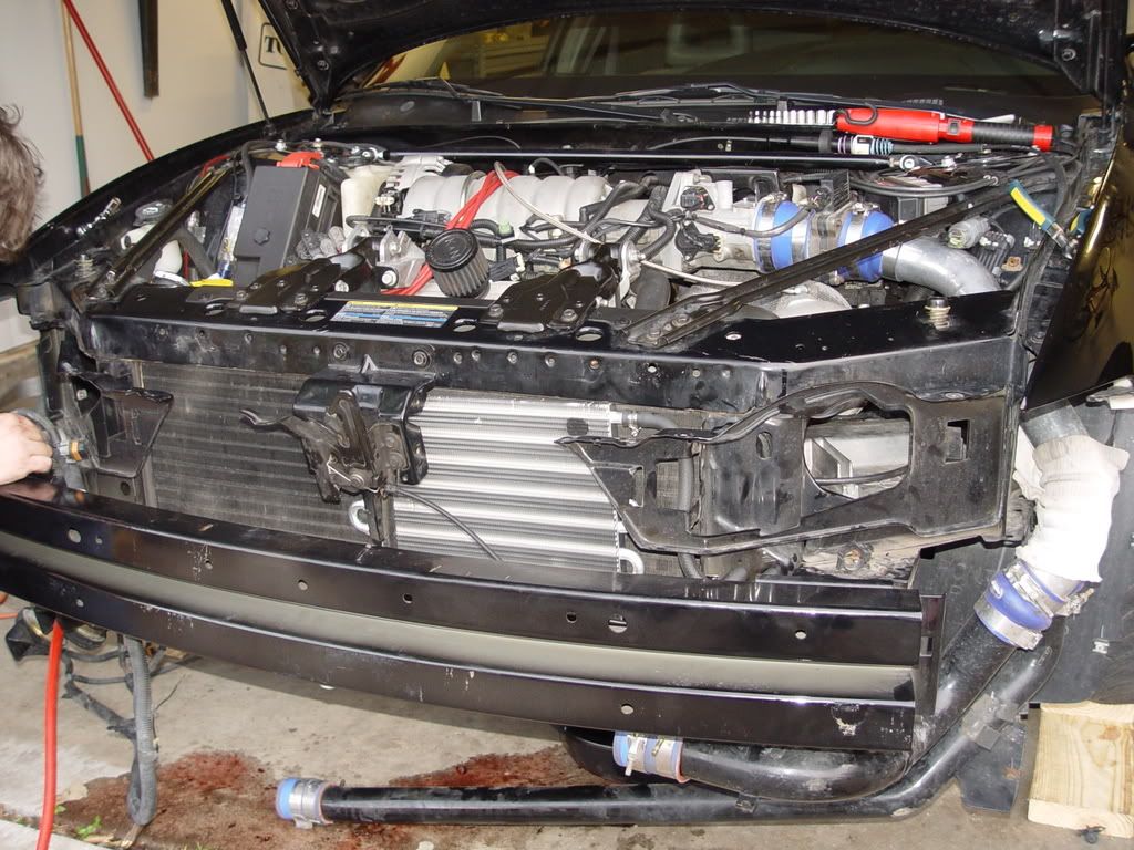

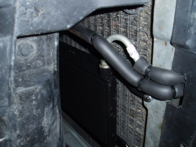

    here you go. Scott helped me get this put in one evening. Had to totally remove the front bumper, even the main one across the front of the car that is actually shown back on the car in the pics. I bypassed the radiator cooler and just using this one. If you can see where the lines run through two holes to the right of the radiator. Originally the hood release cable ran through one of the holes. So i disconnected it and ran it through a hole just below those.

    Definitely bypass the radiator. The coolant in the radiator is only going to heat your fluid.
