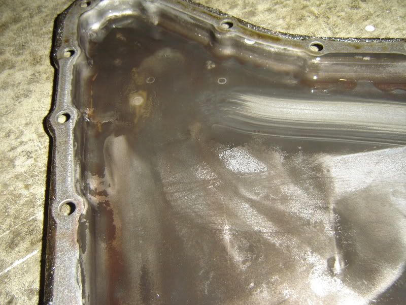

    update. i got the 98 trans from the seller who has the 98 daytona gtp that has ~102K miles. a review of the tranny:
    -98 tranny that was fixed by the dealorship b4 the current owner bought it due to the trans slipping at ~70K miles. this was approximately 5 years ago.
    -ever since then til he stopped driving it back in early 07(tree collapsed on it), he had 10K mile trans flushes done at his shop.
    -drained the fluid via the pan and took off the pan. gasket looked alright but still a tad beat up but thats expected with 102K miles. theres no breaks or cracks on the gaskets.
    -bought a new trans filter today from zzp
    -now, i need to know if the amount of metal particles in the pics below is 'acceptable' for the amount fo mileage on the tranny. whether i should be concerned or not for the amount of metal shavings in the pan. thanks in advance and onto the pics:
  13. #33 Re: lost all gears and stuck in gear 1!!!
    Oklahoma
    8,200
    I dunno, that seems a tad bit more than normal. But trannyman would be better able to judge that than I.
    Now, how in hades did you get that thing up on that platform? Please tell me you did not lift that up on there yourself. If you do I am going to feel like such a whimp, because there is no way in hades I can lift mine up. I tried.

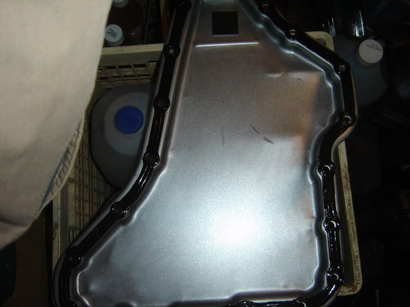

  14. #34 Re: lost all gears and stuck in gear 1!!!
    1,313
    cleaned pan:

    1,313
    lol, anyways getting back on track, what do u guys think of the shavings in the pan? ^_^;
  20. #40 Re: lost all gears and stuck in gear 1!!!
    Oklahoma
    8,200
    I'll put it like this. That 'seems' like a lot of material. What I find puzzling is that there is not that much on your pan magnet, so Im not really sure what to make of it. When I serviced my tranny the first time after buying the car, I had maybe a little less than what you had on your magnet, but my pan was pretty darn clean. So take it for what its worth. I would PM trannyman and point him here and see if he can give you some input.
