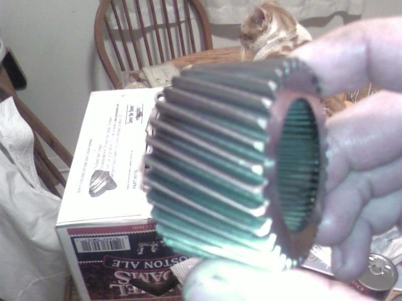

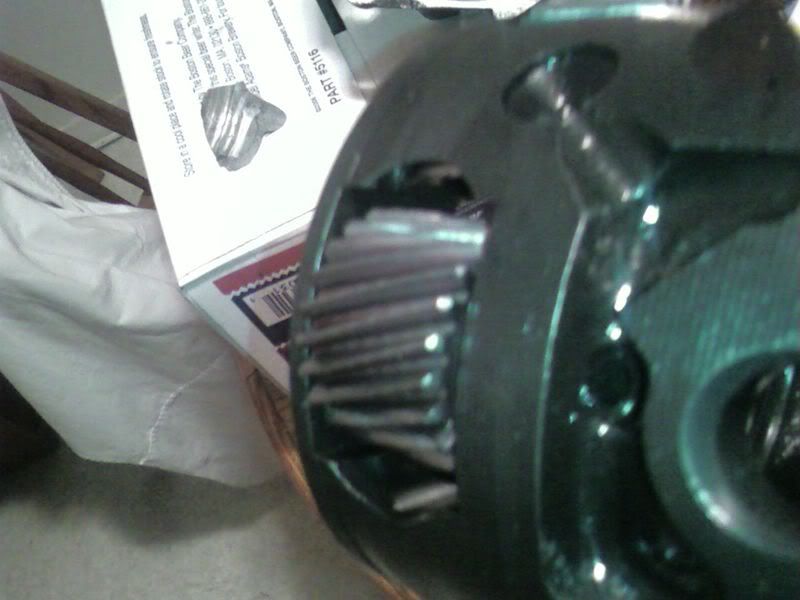

    Well, it's 9PM and in the upper 20s. I finally got my differential out and I look to be in good shape. Only one of the little gears has been damaged, it just broke in two. All other gears are in perfect shape with normal wear. The big pin broke loose and came out the side as you had suspected. I'm a bit concerned because the output shaft came out with the differential, I don't know if that's normal. I was able to get it back in okay, I hope everything works out.
    What are you doing in there cat? Uhh, it's not really green inside the housing. Just a weird camera/lighting effect. Or perhaps I have the RAREST GP of all with it's KRYPTONITE aluminum alloy trans case? Stupid roll pin....
