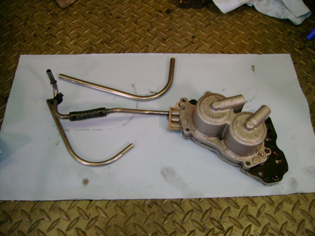

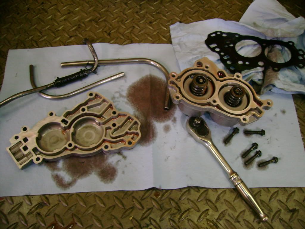

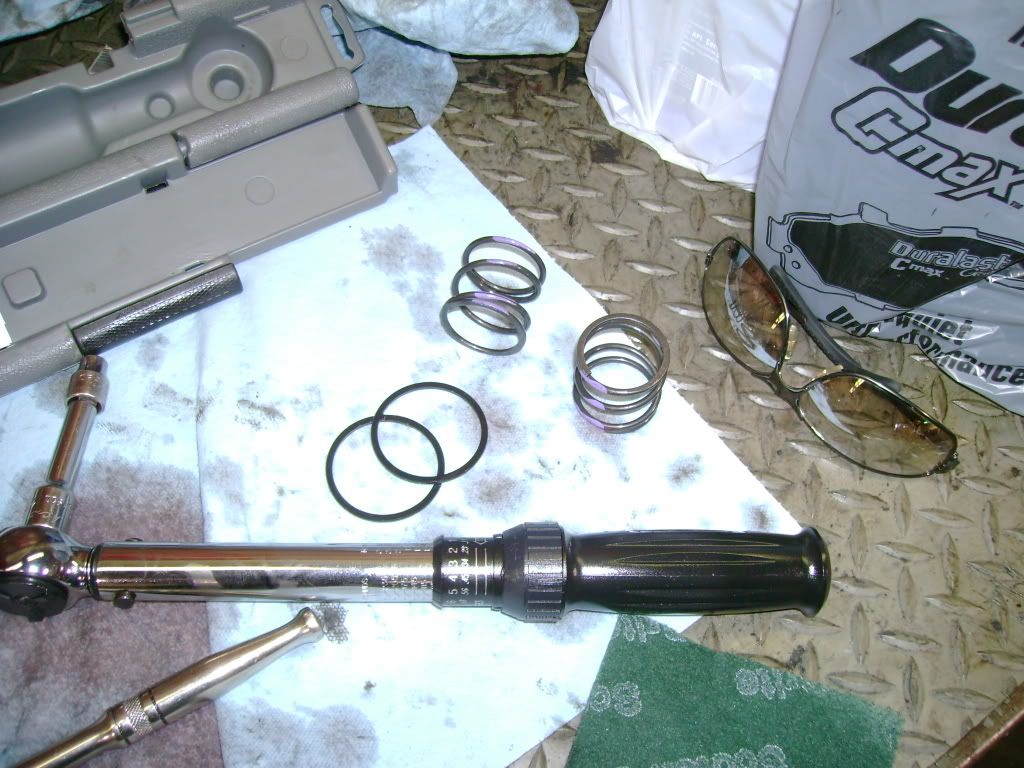

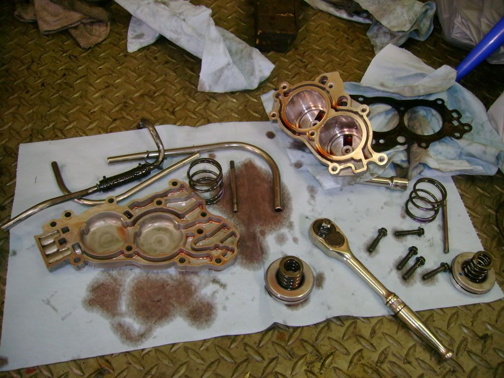

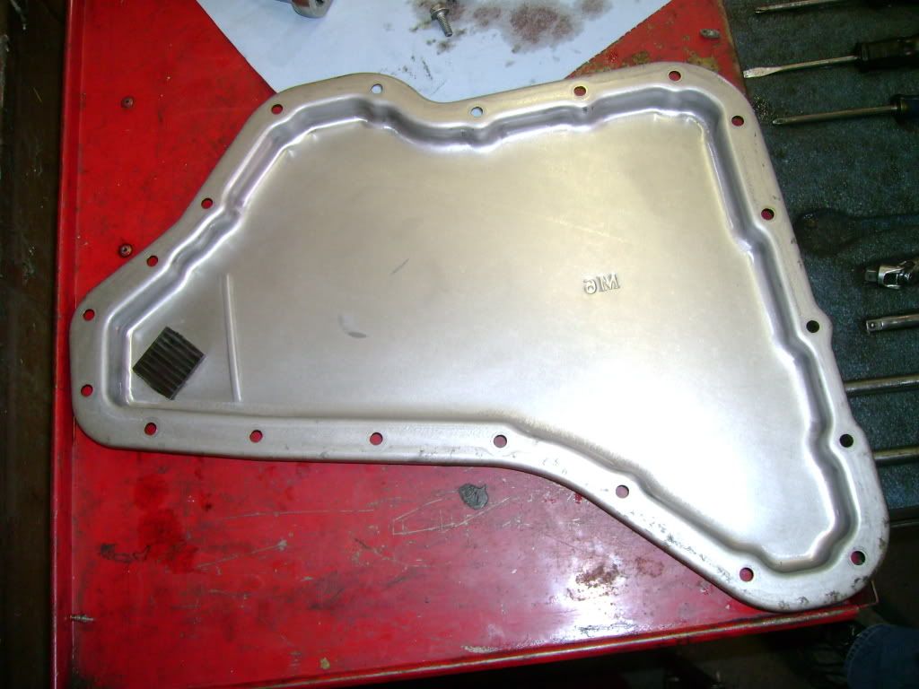

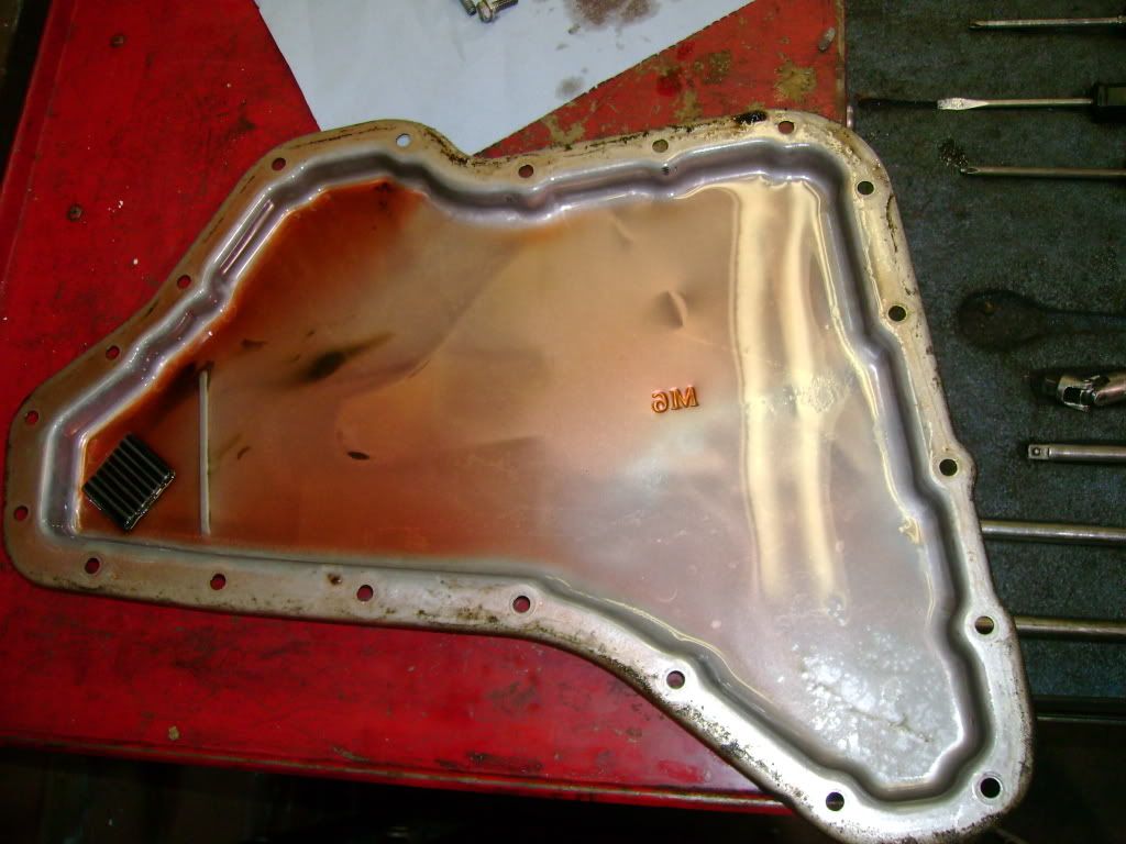

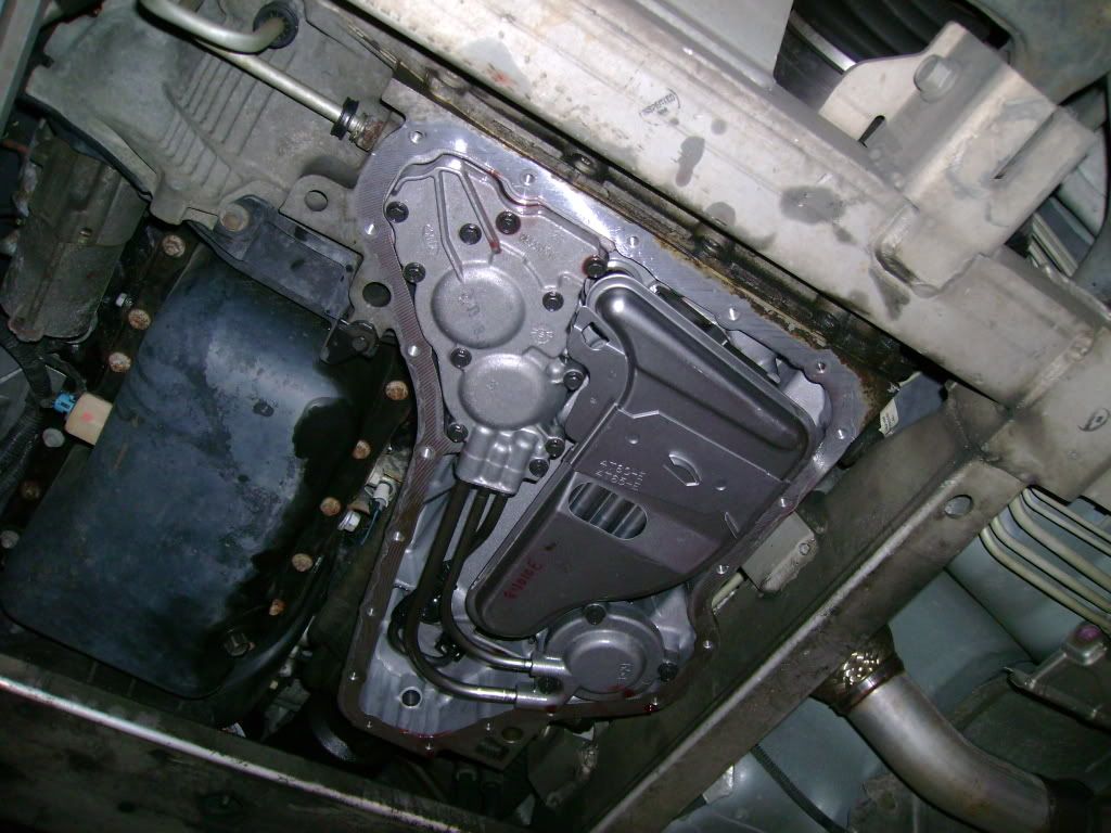

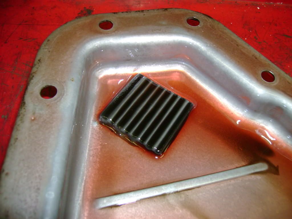

    I'm thoroughly happy with it. Anyone looking for a good kit to make up for the shortcomings for simply raising line pressure should get it. Mild manners during normal driving, then for moderate to full throttle nice and wild shifts.
    Pics from the install:
    Continued in next post

    Continued
    And the kit when I received it:
