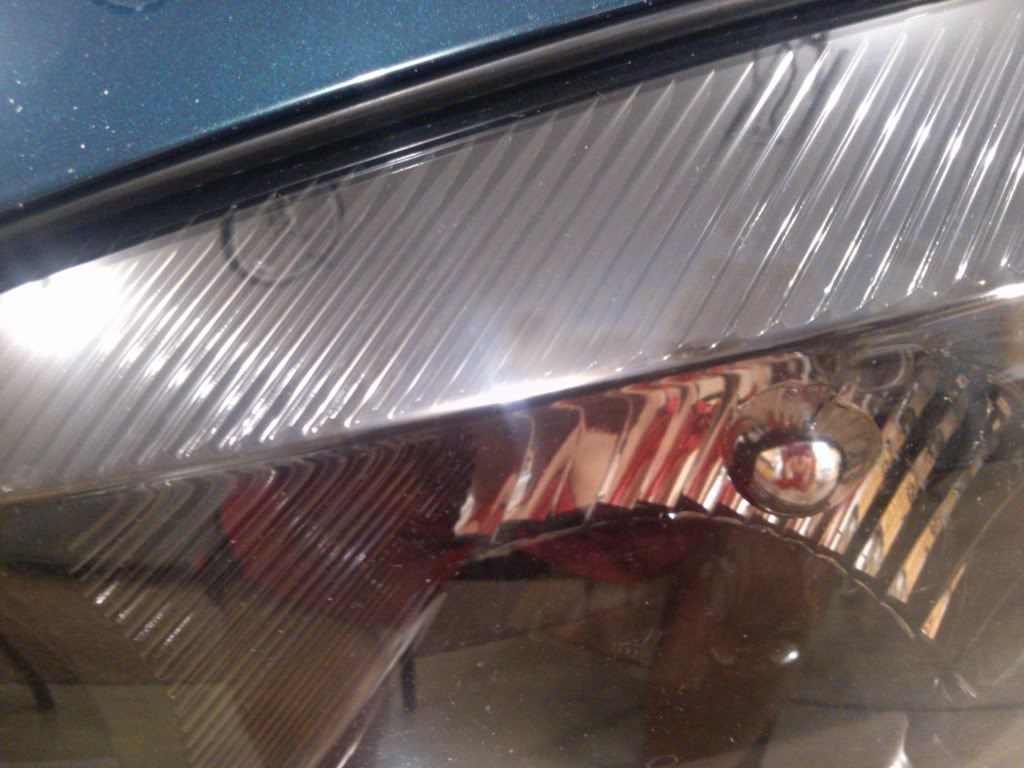

    I got brand new headlights (actual gm ones too) and they are starting to show signs of discoloration on the top and inside of lense like my hids are too hot. Do hids actually burn hotter than halogen? cuz they are wrecking my brand new headlights

    It does spend a fair amount of time in the sun but im positive its in the inside, and its right above where the hid sits in the low beam position on both sides. The day I got them I put wax on them and have done so once a month, trying to see if that will help the outside in the long run

    Post a pic if you get a chance. It could be moisture getting in.

    Well its cloudy and miserable outside but I tried one in my garage. Its much more noticeable when its in the sun

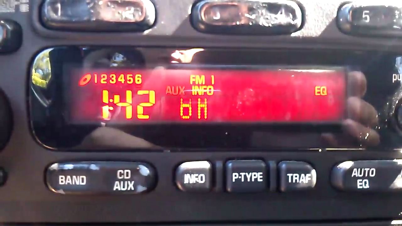

    Also ever since I got the hids my radio has done this occasionally, so just another reason why im going to go back to halogen

    Yeah didn't realize how you can barely see it on here but right above the low beam. I will try some pics outside if it does ever get nice out

    The cloudiness on top of the light happens on all Grand Prixs. It is not caused by the HID's.
  13. #13 Re: Do hids burn hotter than regular halogen bulbs?
    16,085
    Yup you need to put something on it to add UV protection
