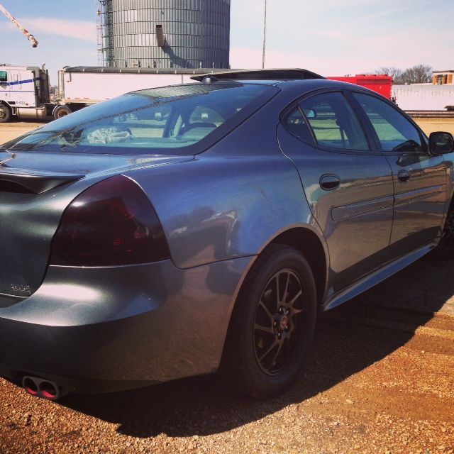

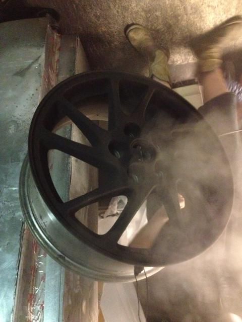

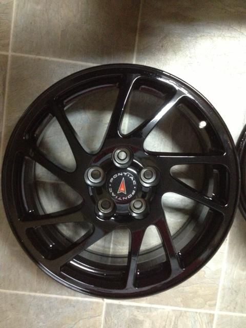

    Well here they are! I did all the prep work myself. Due to the clear coat, and paint on the inside of the spokes the wheels had to be stripped. I used aircraft stripper and ALOT of time with a wire wheel and sandpaper!! They were pre-baked for an hour to burn off any grease/moisture, and to allow outgassing to occur. They were coated with Ink Black and i think they turned out wonderful!! It made such a huge difference in the appearance of the car. 20% tint next week cant wait!
    Before:
    After:
    05' GTP Comp G "pretty in pink"

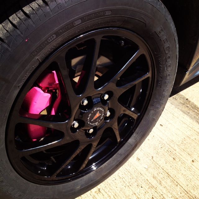

    i like the pink calipers too.. nice and subtle

    Those look great. How did you do the pink in the exhaust tips?
    2002 Impala- SSC, AGX, 18" charger R/t rims w/8mm spacers, Magnaflow cat, U-bend delete, flowmaster 80 series crossflow, z28 tips, HAI, debadged, 35% tint, smoked headlights, full sound system
  18. #18 Re: Powder coated wheels!!! 05 comp g
    SE Level Member MissLexx's Avatar
    Apr 2013
    Brookings, SD
    41
    just used some of the left over caliper paint on the inside
