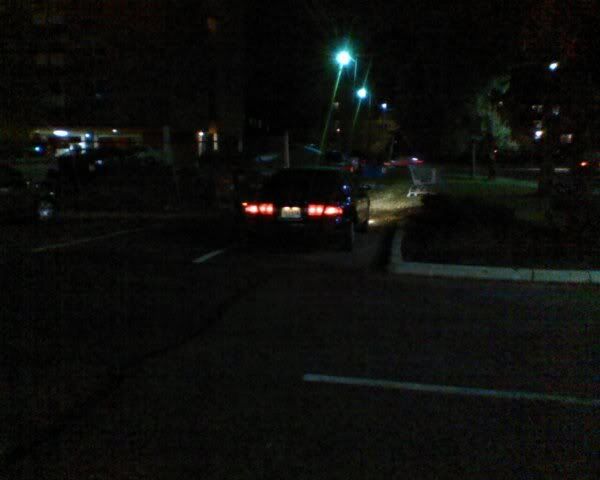

i did 2 coats of vht, and 5 coats of clear wet sanded the clear and buffed them up. 2 coats is not blacked out, but dark cherry look, 3 coats or more and its blacked out good. i wanted my brake lights to be seen during the day time.
stock daytime lights on
tinted daytime. no lights.
and what i got at night.

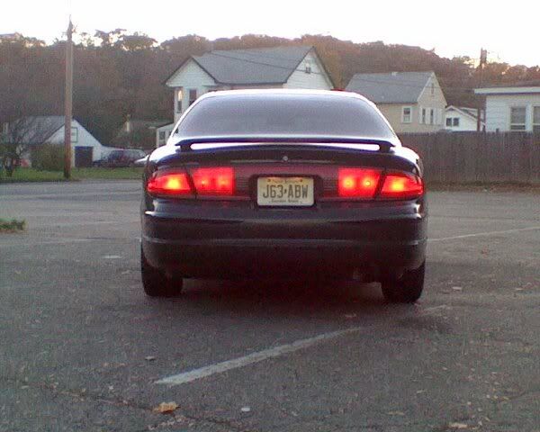

part of the prep is to wet sand or Scotch brite pad the lens then clean with a prep spray. tape them off and then spray em. sanding them lets the vht bond better. and they can always be buffed back to a stock shine if you wanted to.
note how dull the tail light looks.
