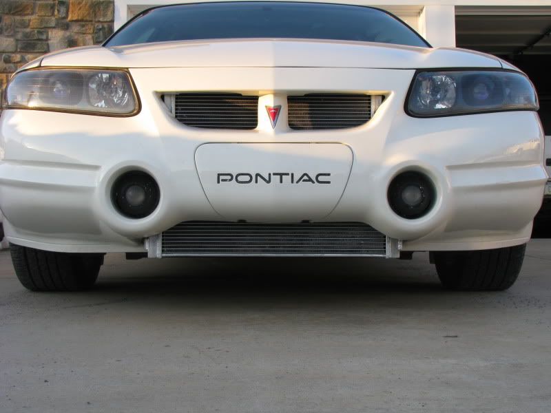

summer

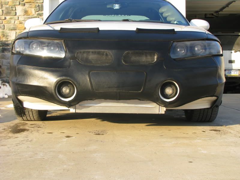

winter

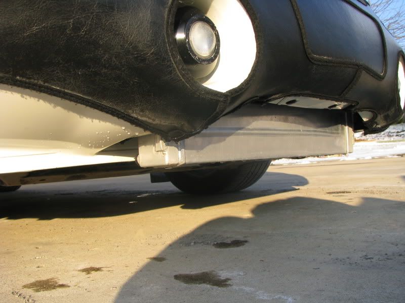

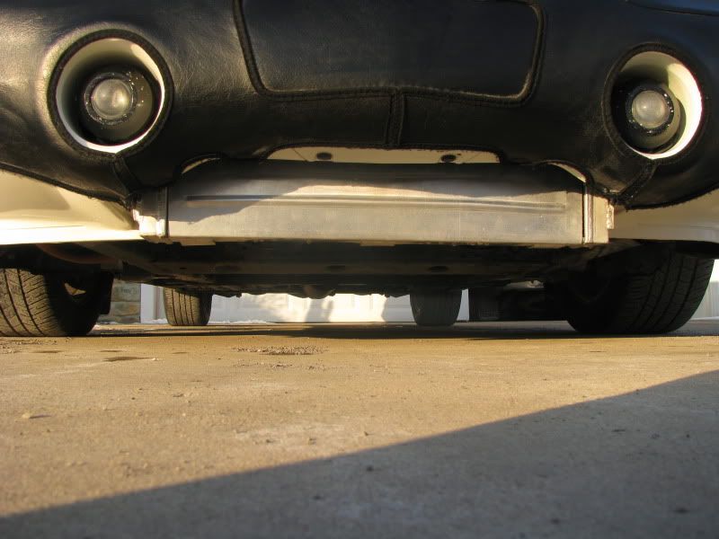

Now the big difference is Alum Blockoff Plate for the Lower Heat Exchanger will Help with temps in the winter, but also save the bottom HE from the Rocks and the salt ect.
I fabbed this baby up in Our Street Rod and Custom Fab Shop. It started as a Alum Sheet, cut to size with the sheet metal Shear, then made some 90* bends with the sheet metal Break, used the bead roller and then TIG'd 3 brackets on the bottom.
