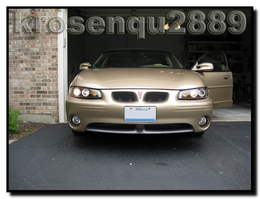

    Hey guys/gals. First time poster / long time lurker. Anyways:
    Stock (except for these lights): 1998 Gold Grand Prix GT 81,000miles
    Installed the Dash-z style projector headlights today (05/15/2010).
    Paid $200 shipped.
    I haven't done any night / aim testing yet. Only testing for fit. I also haven't hooked up the led's and halos yet. I'll splice them into the fogs eventually so I can use the switch.
    So far, I'm disappointed. The fit on the driver side is ok except for the gaps (see post #8 on this) but the fit on the passenger side is off. Stock headlamps are just fine.
    I'll let the pictures do the talking.
    Before:
    After
    This gap is here on driver and passenger side:
    This is WAY too tight!
    You'll have to forgive me for these vids... I was quite grumpy by the time I made them lol. Words such as "fail" and "waahh! I cant do it!" follow:
    You guys have these problems or is it just me?

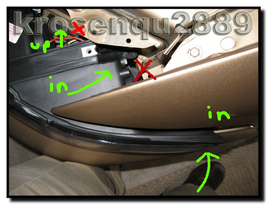

    Here are some more images of my issues. Hopefully this helps others as well that may have the same issues.
    Here is the stock outer mounting bracket next to the Dash-Z style headlamp housing:
    And here is the problem:
    Here is another design problem. This piece on the car is hitting the back of the headlamp housing.
    Here is the problem:
    As a result of the height problem of the mounting bracket, and the clearance issue above pushing out the headlamp, I get this:
    Here is the stock headlamp housing for comparison:
    In summary, I'm going to try and return them. And I'm going to be dissapointed if they don't refund the $35 shipping (unfortunately, thats not usually how it works)! 3hrs of my time X(

    You didnt have any of these clearance issues? Does your car look similar to mine? Im trying to figure out if this is my particular car or if the design is bad for all models.

    same style car. 97 gtp. mine fit almost as nice as stock lights. very flush and the only gaps is a very small one behind side turn signal, not even enough to wedge a pinky in tho.

    I suppose its too much to ask, but do you remember if these pieces were close, or if they were designed differently?
    I haven't seen any pics of the headlamp housings that are different than mine. I'm assuming its my car thats different.

    Yea those areas hit on mine too. If you were in an accident (like I was with my old GT) then the mounting brackets would have been bent. The headlights are a little pushed in on my old GT.
