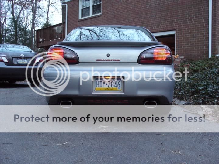

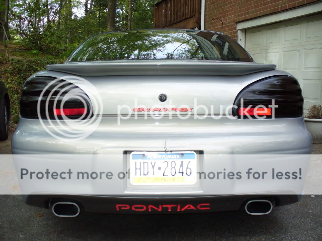

    I tried to add on to my orginal post but it wasnt working out. Anyway... here are my tinted tails i used 3 coats of VHT nightshade and 4 coats of clear. I love how they turned out. Also thanks for the help JoRow99!!
    Original
    Finsihed...
  2. #2 Re: Tinted Tails Finished Product(PICS)
    a little more wet sanding and some more clear and theyd shine up nice.
  3. #3 Re: Tinted Tails Finished Product(PICS)
    Norristown, PA
    2,606
    ^ what he said
  4. #4 Re: Tinted Tails Finished Product(PICS)
    MO
    3,619
    wetsand them now then wax them.

    Ok sound like i will be doing a light wet sanding tomorrow, another coat of clear, and a little buff job.... this is such a great cheap apperence mod!
  9. #9 Re: Tinted Tails Finished Product(PICS)
    Grand Island, Nebraska
    2,015
    lol np. careful when sanding the final clear coat, because it wont be shiny anymore. you need polish to make it shine if you do that. i just got lucky and didnt have to do anything after my last clear coat. btw thats a nice level of darkness!

    Quote Originally Posted by kjclawson View Post
    After you wetsand, use rubbing compound, then polishing compound, then meguiars ultimate compound, then how ever many coats of wax you want. That's the easiest way I have found to bring the shine back.

    looks like you were doing spotty coats, holding the can far away and spraying lightly. if you look at my tinting writeup, thats how my first coat looks. the 2nd coat is heavier and has hardly any texture. wetsanding and polishing after that makes it almost perfect
    you will need some 1000-2000 sandpaper to get that texture out. it will look like complete crap, but compound and polish buffs it right out

    This write-up should defiantly be put in the How-to section to replace the other one considering the one in there is not half as good. good job!
    And also to get mine looking a little better should i wet-sand with 2000 grit, clean and dry, polish and buff, and then is that it?

    If you really have 4 coats of clear on them, yes.
    Wetsand thoroughly with 2000. Then use a polish (meguiars #7 is what I used). After that give them a coat of wax to protect them.

    yeah, i really don't think you need to use a polish like meguiars m205 or anything that has a cut to it. that duplicolor clear isn't super hard like GM clear coats are. I used to get great results doing it all by hand. Then i switched to using a porter cable for the polishing and that made it look even better. easier to do to
