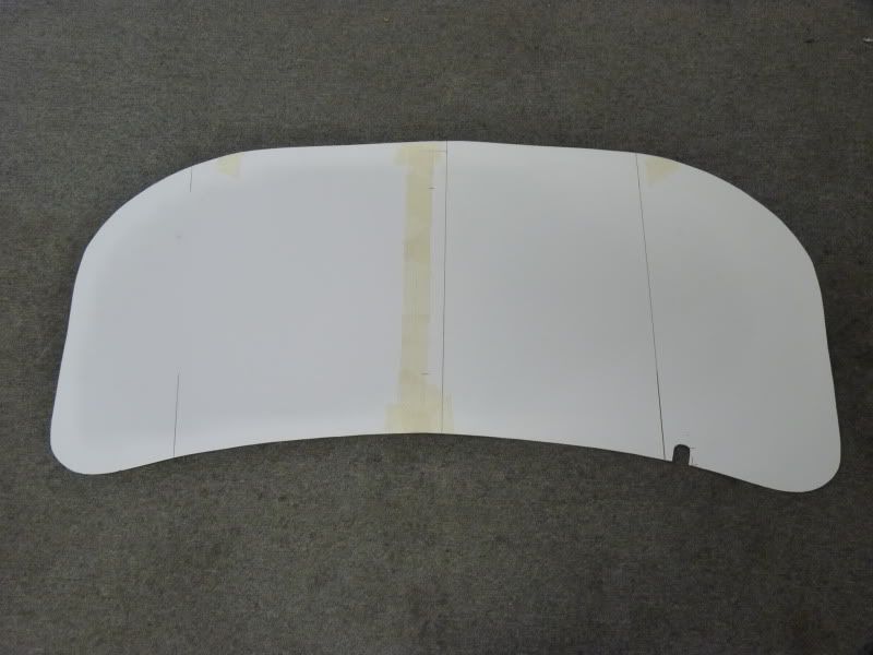

    With pattern in hand I then transferred the pattern to the heavier poster board I had, just flipped it over to do the other side. This is what I have.
    With some minor trimming I was happy with the way it fit. I had also bought a 3 pack of 3/16" 20"x40" foam board, I think the cost was $10. It's light yet still durable, only pain was the mat was going to be 41" so I had to make 2 pieces. I'm also doubling the thickness, so my mat will be
    3/8" thick when done.
