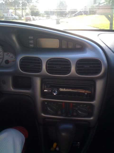

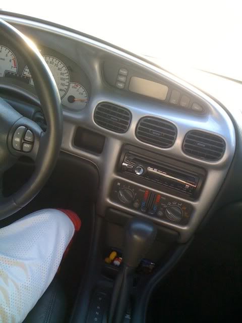

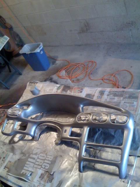

    So long story short I got strep throat and had a few days off of work to do this project. It took around 7 hours all togeather. I used krylon fusion Hammered Silver & Krylon triple clear glaze clear coat. As a bunch of you guys know there were lots of frustrating parts in this but it turned out pretty well. Anyway here are the pics, and a thanks to Patrick over at GPONA for help.
    Painting:
    Final:
    Let me know your thoughts. And sorry for iPhone pics.

    how did you prep the plastic?

    I prepped it by cleaning it with a degreaser, then I wet sanded with 400 grit, then 600 grit
