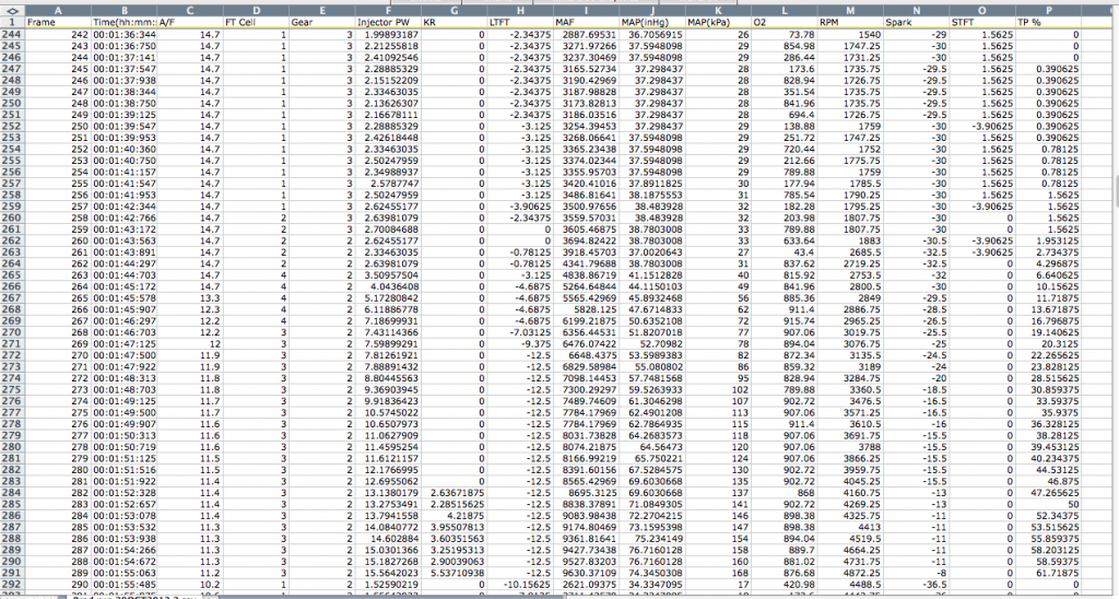

    It's not a 98 PCM. It would not even read the file till he updated the software, but reads fine on his car. So we put a stock tune on then tweaked it a bit with zzp base file. We did full writes any time something was changed. We changed the TPS and did not make a difference. I think it is just relearning the shift. What we are worried most about is the knock now. After doing a run we noticed the TP% was not matching up with the MAF frequencies. At like 61% throttle it was at around 9400hz. When on his car 9400hz is 91% TP. And seeing how the files are to big to post I can't post them here. F***!!!!!

    Here are the codes and the first scan is modified timing, second is stock.
    P0101 P0102 P0103 P0107 P0108 P0112 P0113 P0117 P0118 P0121 P0123 P02A8( is this???) P0441 P0503 P0506 P0507

    In reply to your pm and after looking over what has been suggested, I agree with what has been said already. It is likely that the OSID of the bin that is currently in the vehicle is not correct. Use the websites bill mentioned to locate the most current OSID and use it as the base for your tuning. As for the tp% vs maf. It is possible the maf is dirty. But rarely will one cars tp vs maf be the same. Especially when diff mods are installed.
