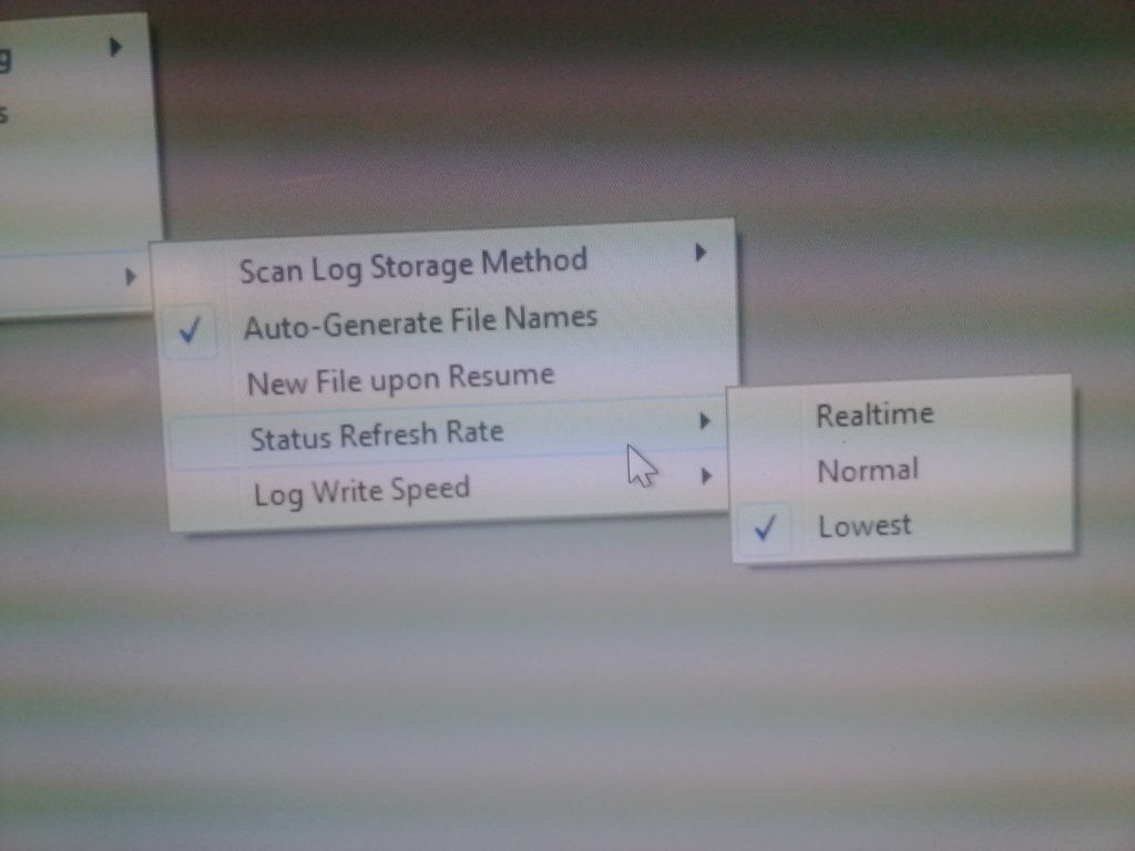

check some settings.
http://i1097.photobucket.com/albums/...psmdumdvjf.jpg
http://i1097.photobucket.com/albums/...psckdtyr58.jpg
these bottom two are set to lowest. all these should be default settings
http://i1097.photobucket.com/albums/...psf5lnwu1s.jpg
Yep I have all those settings.
