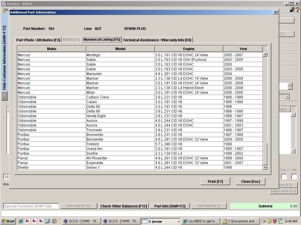

they're for a lot of things...http://i124.photobucket.com/albums/p...untitled-1.jpg
And thats not even half of the cars it fits.
