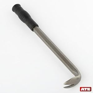

Looked like a newer house so probably 16 gauge finish nails from nailer? pull any nails stuck in trim from the back so you don't blow out chunks in the face side.
What I use because you can roll it for leverage.

Scottydoggs
funny part is that small pry bar. talking maybe 6 inches long. looks like a kids toy. but works great with little to no damage to the wall or wood trim.
the cats paw will pull the trim nails so you dont pull the nail through the wood and risk splitting it. the small one also looks like a kids toy.
I have this one http://www.lowes.com/pd_36595-995-3410350_4294857575__?productId=3084941&Ns=p_produc t_qty_sales_dollar|1&pl=1¤tURL=%3FNs%3Dp_pro duct_qty_sales_dollar%7C1&facetInfo=... and a larger one...can't find a pic of the smaller one.
