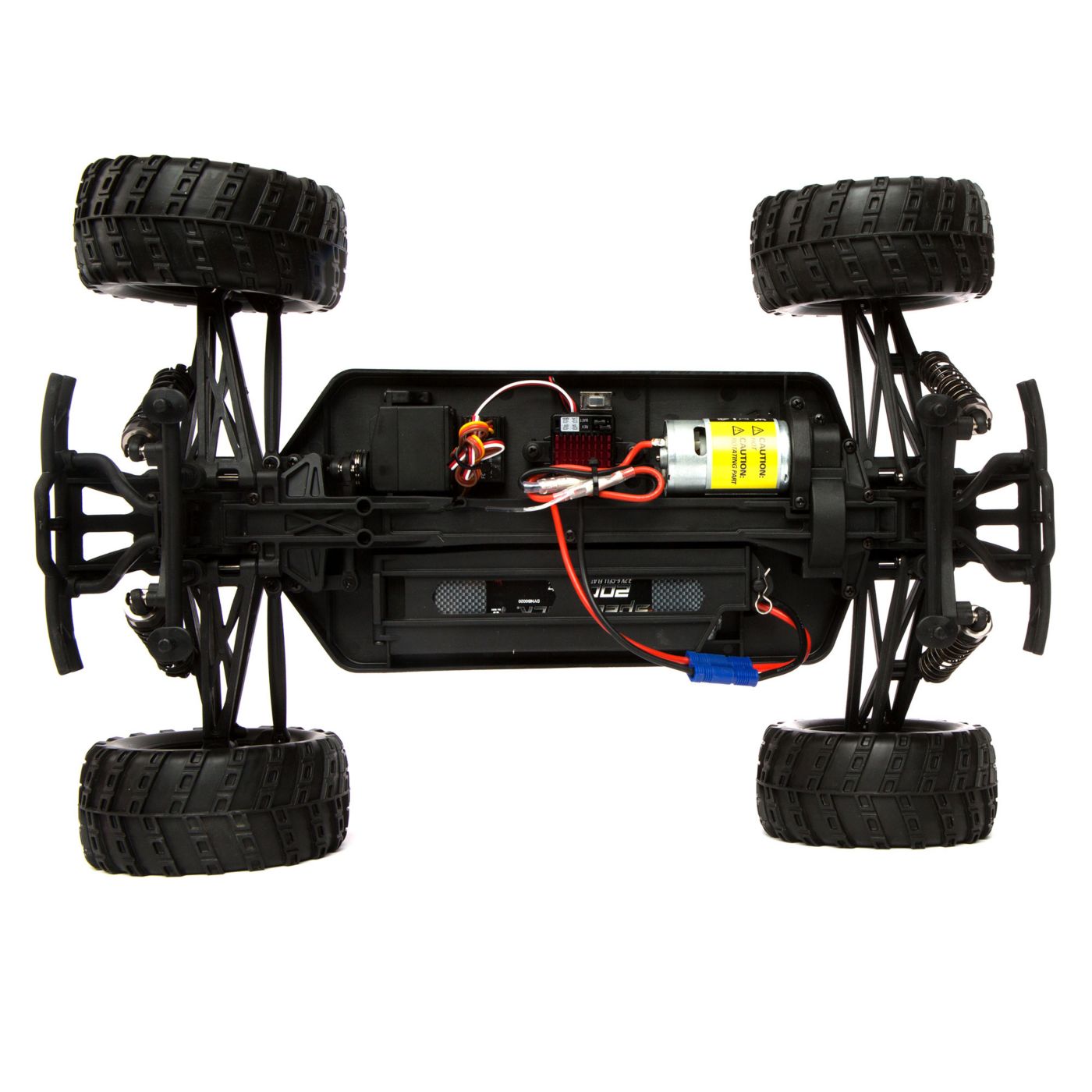

bowie iron track i believe
This truck right?
https://s7d5.scene7.com/is/image/hor...FCES03001T1_a9
Horizon Hobby distributes that under the Force RC Outbreak 4x4. 1/10 Outbreak 4WD Monster Truck RTR: Red | HorizonHobby
Front/Rear CV Set (2): 1/10 4wd All | HorizonHobby
Iron Track Bowie 1:10 Scale 4WD Electric Truck Ready to Run (Green) RC Remote Control Radio Car
hmm. looks like it, without all my better electronics, interesting
And HPI released the Exceed cars under the Maverick Racing name lol. Maverick Radio Control Cars
so exceed and mav, or exceed is maverick now?

Actually the OEM is HSP for Exceed Maverick and Redcat Racing. All 4 sell the exact same car with different colors and graphics on the body and different electronics.
HSP 94107TOP
http://www.hspracing.com/images/Uplo...9151711974.jpg
Exceed Sunfire
https://p11.secure.hostingprod.com/@...w-24Ghz-12.jpg
Redcat Racing Tornado
https://cdn8.bigcommerce.com/s-qkqgl...381474.jpg?c=2
Maverick Racing Strada XB this uses a slightly different chassis top plate and the chassis layout is reversed.
https://www.align-trex.co.uk/media/c...12613-da68.jpg
