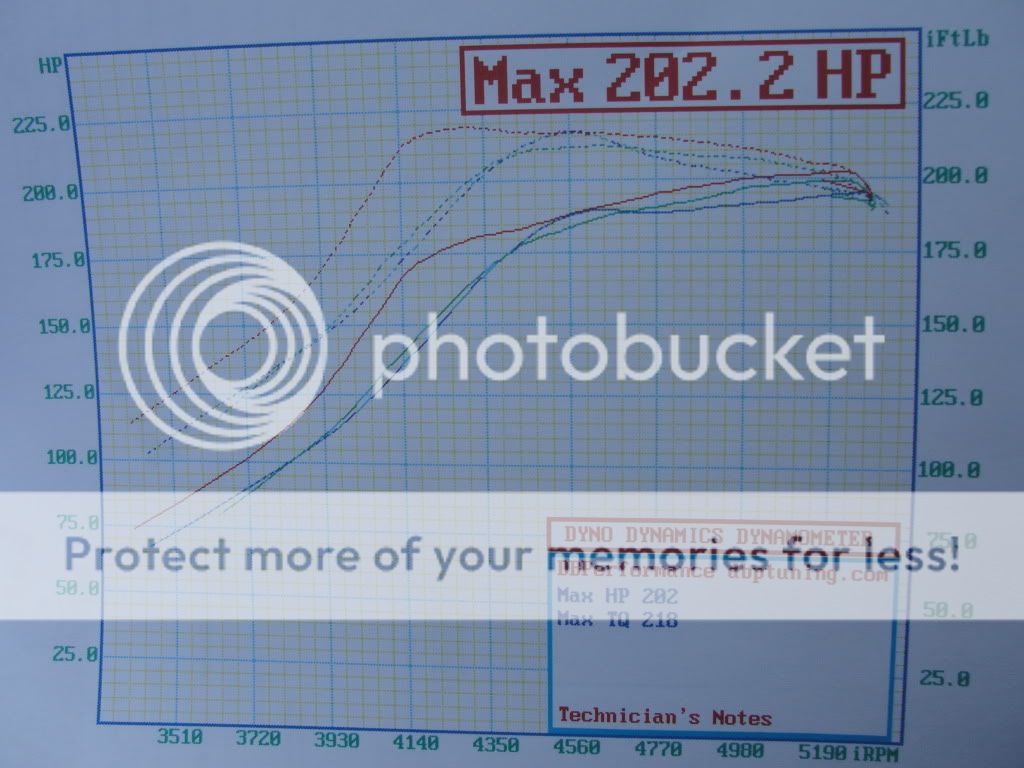

The other run was around 196whp and I did not get a video becuase I was not ready yet.
202.2 whp
218 torque
around 8 PSI for boost
http://i935.photobucket.com/albums/a...4/DSC00666.jpg
http://i935.photobucket.com/albums/a...4/DSC00664.jpg
I am suprised to see that the torque was that low, but I am very happy with the results.

Whats with the differing torque peaks?
Did he hit WOT later on?

He said that the torque converter was locking up in different spots and because we didnt have a tuner up to it, we could not lock it from the get go.

Converter would be unlocked for WOT.
But differing unlocks would make different spikes.

If you want mathematics...and your typical 20% drivetrain loss through the slushbox65E-HD...a stock GTP is rated at 240/280...
So...to the tire your looking at 192/224. So he wasn't THAT far off.

Also...something to note...Cam does have something to feel good about because a Dyno Dynamics Dynometer is known as being the heartbreaker dyno...for giving crap numbers.
