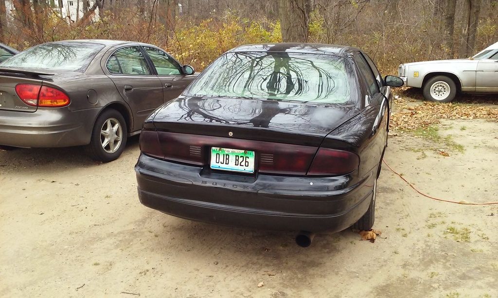

I decided to black out some of my regal today
http://i304.photobucket.com/albums/n...ps7qtjjtio.jpg
http://i304.photobucket.com/albums/n...ps66dksrdk.jpg
Swap front bumpers with scotty
no you dont, but you can prep and repaint your like scotty did. :th_thumbsup-wink: yours looks as bad as mine did. 50 bucks in paper and paint and its new again.
Also a little wet sand and clear to make those tails look wet and shiny
Yeah. i planned on another coat, but it started to sprinkle a bit so i put them on for now. I plan on a few coats of clear and polishing that. Ill probably repair the front bumper in the spring time.
if you cleared the tails wet sand and then buff with compound.
