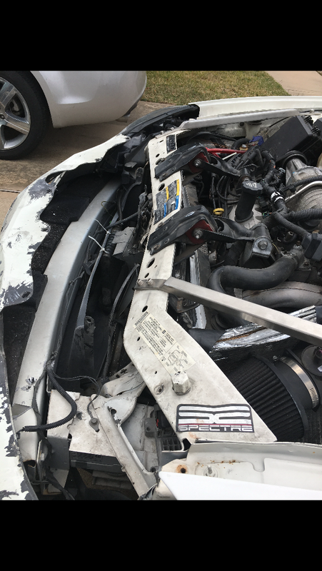

So the next week I leave to go out of town and coming back from the airport this happens.
This is what happens when you don't pay attention and screw up:
http://i2.photobucket.com/albums/y5/J57ltr/IMG_8454.jpg
So I am in traffic and I dropped my wallet and reached for it when traffic started moving and it stopped and I kept going and ran into the receiver of a full size truck and it popped me right in the core support. Smashed the latch assembly flat against it and bent the core support back and down about 5" Everyone was OK and we waited about 2 hours for a cop to show up. Several tow trucks came and went. I removed the hood wile we were waiting and had it off and moved the loom for the PCM and a few other things away from the manifolds. The fans were pretty close but the car was running and no leaks so I figured I would just drive it home. Well the cops show up and decide that my car is undrivable because it doesn't have a hood, even though it is not required in Texas. Kinda like you don't have to have a windshield but you do have to have wipers. Well I am not going to argue the point I just asked if they would check. They said I wouldn't be able to drive it and so I told the tow truck driver that I was going to have it taken to my house, which is 27 miles away. He didn't really want to drive out that far so when we got off the road and into a gas station parking lot he said he would drop me in an area around the freeway and I would "have a friend with a trailer pick me up". So he drops me in a grocery store parking lot that just has a construction size trash container in it. The security guard sees me and tells me to wait 30 minutes and throw it in the back side of the dumpster. I so that and it's starting to get close to dark as its about 4:15 so I take off and drive while watching temps and such everything is staying cool, no funny smells or anything. I can see the heat rise from the engine compartment as it's a bone chilling 48* out, so that was kinda neat. I get the car to the house right at dark with the driving lights and parking lights on. I start taking inventory of what I am going to need and it's a pretty decent list. Core support straightened about 4-5" back and up. Need new headlight, bumper cover, header panel, latch assembly, Radiator and condenser.
http://i2.photobucket.com/albums/y5/J57ltr/IMG_8507.png
I drive it 20 miles to the shop and start to try start bending the core support back into place and apparently its freaking thick, I picked up the whole car and didn't move the support at all.

ouch. that sucks.
Damn dude. That sucks At least you had a chance to enjoy your work before it happened.
and wow that support IS strong. Can you spot weld? You find core supports online for around $150 shipped. I replaced mine and just needed to drill and spot weld
edit. If the regal is the same part # I'll send you the link where I got mine from unless you're gonna get a used one.
