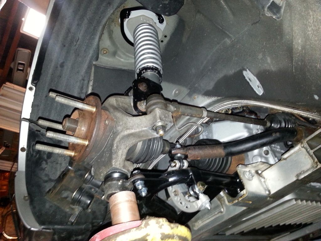

Love it, curious as to why u went through all that for the sway bar? Endlinks
Re: 2000 turbo regal v.notSnowflake *now with more flames*
the zzp design sucks, its too short, too high of an angle change at the bar to retain the pancake bushings.
now the links are nearly 4" long, less of an angle at each end and nice smooth heims with no play. yet I can still add about a 1/2" of preload to it to help counter tq steer or at least make the bar truly neutral with just the driver in it.
I widened the zzp mounts to fit high angle washers next to the heim.
I wish I coulda hacked off the ends of the BMR sway to put heim tabs there but I got a heim to work with a nice high pivot point. then I coulda kept the zzp arms right side up instead of flipping them, but the links still woulda been short.
he does want to fix the roll centers with the steel knuckles and monoball pins/joints at the LBJ so I did want something to match the rest of the suspension as far as not having any deflection.
the only things we have to contend with now is any movement of the subframe from the rubber bushings (im working on that one) and the flexing of the strut body/shaft and the unibody sheetmetal.
now I shouldn't have to dial in nearly 3* of toe in to end up at 0 under power and have it go where ya point it. stock junk moves too much.
right now im waiting for the right piece of 3/8ths 304 plate to fall into my lap so I can make the LBJ plates and weld in the monoball sleeves. but for now its drivable lol
yeah I looked at a monoball sleeve welded to a bolt, the problem is the swaybar pancakes, they suck. I looked at welding the monoball rings to each otherwith tabs at the swaybar welded to a bolt through the hole, it was too short and hit some hard angles likely to eventually break off the zzp tabs
now they are ~1" above the LCA and the link is 3.5" long.
over-engineered junk
you still interested in the knuckle/pin/LBJ/roll center stuff?

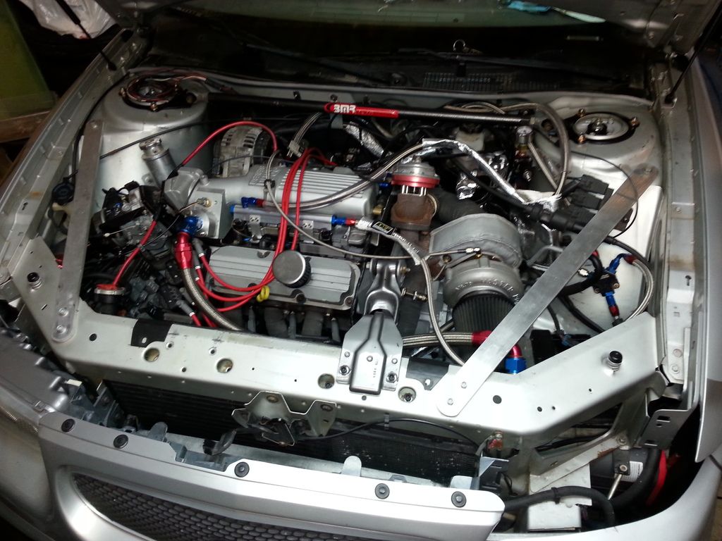

meh, its slowly getting there... fuel rails anodized and sealed up with viton O rings for ethanol, remade the buick Tq link plate for more harness clearance and to drop some weight. made an extra just in case i **** this one up.
strut bar and mounts are in, alignment is set at full positive camber at the camber bolts so that i can do final adjustment at the CC plates.
http://i260.photobucket.com/albums/i...pscsaaka6a.jpg
so then i moved onto the T stat housing and its conflict with the triple stack ICM/coil setup. i have to shorten the -16 hose but it'll fit now!
http://i260.photobucket.com/albums/i...pswpesajie.jpg

runs great, wheels on, almost on the ground, ready for a drive even!
