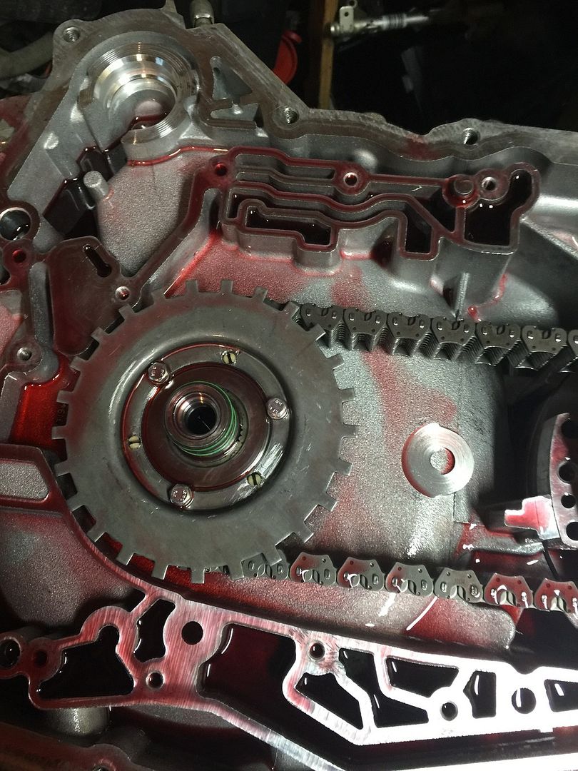

  4. #284 Re: 2000 turbo regal v.notSnowflake *now with more flames*
    26,833
    How were you guys attaching the reluctor, can't be stock pins.... you have to be a 1" which means bolts?
  5. #285 Re: 2000 turbo regal v.notSnowflake *now with more flames*
    hangover park IL
    2,714
    11
    Yup
    Broke 3bolts
    Im going to thread all 6 and hole the dimples
    Ill just trim the thrust washer legs short
    ~James~ Psychotic Gearhead
  6. #286 Re: 2000 turbo regal v.notSnowflake *now with more flames*
    26,833
    Weld... Just saying from someone who could rip a relucter off any pins, bolts etc etc.
    Weld... you love welding

  8. #288 Re: 2000 turbo regal v.notSnowflake *now with more flames*
    SE Level Member SlowFiero's Avatar
    Feb 2008
    Canada
    83
    Gears are powdered metal, welding is not a good option.

  13. #293 Re: 2000 turbo regal v.notSnowflake *now with more flames*
    Feb 2008
    Canada
    83
    You do need the center of the reluctor cut out, the gear is the bearing surface on the 1" setup instead of the reluctor, if you don't cut it out, there will be too much load on the reluctor and it will want to shear off, I believe this is part of the issue with the 7/8" chain setups, the stack up is too thick and overloads the rivets. I got the 1" setup so never followed through with all the measurements on the 7/8 to prove/disprove.

  15. #295 Re: 2000 turbo regal v.notSnowflake *now with more flames*
    GXP Level Member
    Mar 2015
    Tomball
    2,633
    Quote Originally Posted by SlowFiero View Post
    Dave at triple edge told me not to weld.
    I'm on 3 years now, red locktite, and lock washers, so far so good.
    So what does the reluctor need to be opened up to diameter wise? The way this pin deformation and the heat treat lead me to believe that these gears are not PM gears.
    Thanks,
    Jeff
  16. #296 Re: 2000 turbo regal v.notSnowflake *now with more flames*
    Feb 2008
    Canada
    83
    Cut out the whole inner area of the reluctor, leaving only the flange where it bolts on. There is a step there where the reluctor is thinner and polished for the thrust washer in the stock setup. The thrust washer must fit inside the hole with no interference. The reluctor will spin with the gear, and must not hit the stationary washer.

  17. #297 Re: 2000 turbo regal v.notSnowflake *now with more flames*
    Feb 2008
    Canada
    83
    Went back and looked at emails. Oem gears are powdered metal not the GMR I guess.
    Billet 6262 T3 turbo, PT1001 intercooler, ST1 cam, 140 springs, pushrods, N* TB, L26 upper, HV3, otherwise stock L32. 10.007 @ 135.54with 1.46 60' 3130 lbs
    Old GenV M90, XP, heads, N* TB, ST2 intercooler - 11.425@115.60 1.54 60'
  18. #298 Re: 2000 turbo regal v.notSnowflake *now with more flames*
    GXP Level Member
    Mar 2015
    Tomball
    2,633
    Thanks, I couldn't tell if there was just trans fluid at the step or not.
    Jeff
  19. #299 Re: 2000 turbo regal v.notSnowflake *now with more flames*
    Feb 2008
    Canada
    83
    Not a great pic, but kind of shows it.

  20. #300 Re: 2000 turbo regal v.notSnowflake *now with more flames*
    hangover park IL
    2,714
    11
    it was MattM's old 2.93 sprockets from the TTGT/BFTGT....after he snapped the 1" gmr chain launching on nitrous
    i didnt change a thing to it....but maybe i should have
    not welding the tone wheel to the gear, you bolt the tone wheel on and tack weld the bolt to the reluctor/tone wheel instead of safety wire to prevent backing out.

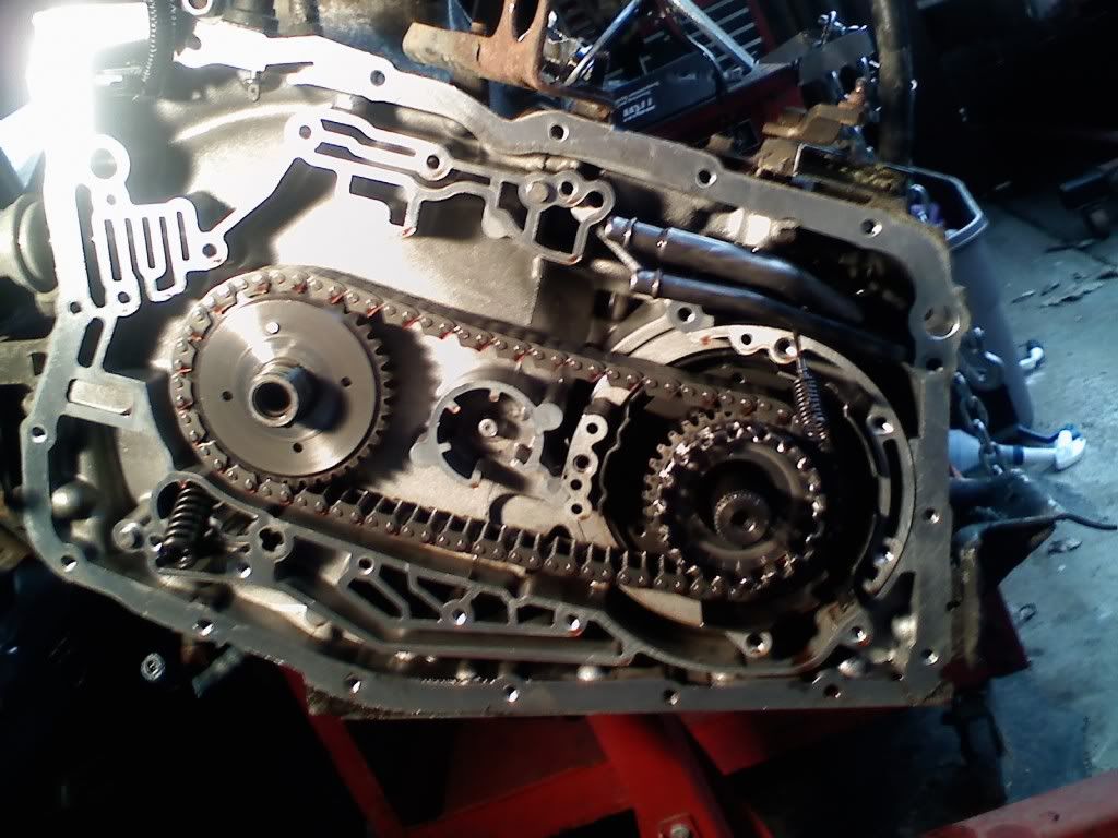

    the 7/8ths setups are just modified 4t440/4t60/4t60e sprockets and they didnt have an ISS that i know of.....
    from what i recall there's machining for the 4t65e reluctor/tone wheel required to put it in the 65e
    pic of 7/8ths 4t60e
    correct these gears are billet, you can still see the gear hobbing marks most of the gear guys are guessing that the gear is 4150 steel
    at this point im machining lightening holes in the reluctor/tone ring...also probably going to thread all 6 holes and bolt it on with 6 vs 3, all im gonna do is trim the legs on the thrust washer.
