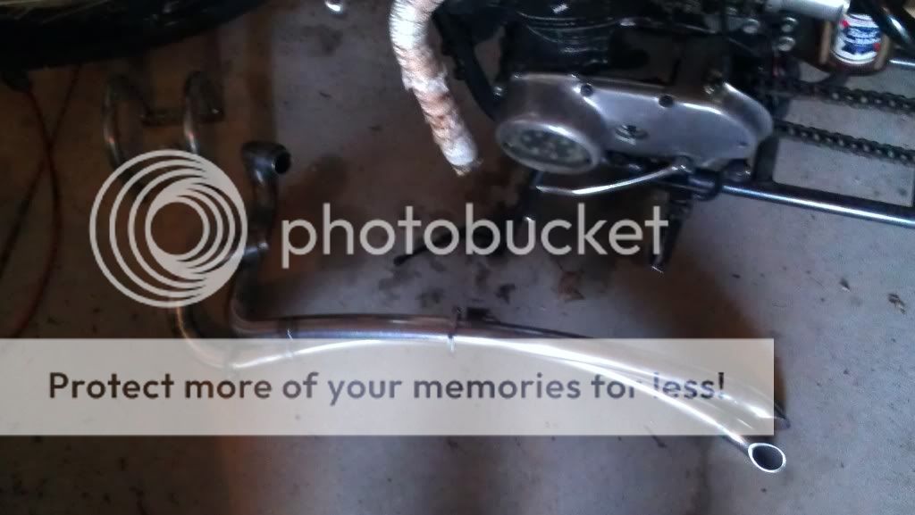

got the fork brace and exhaust in, teaser shot.
http://i520.photobucket.com/albums/w...sfa784606.jpg?
probably will mock the parts up this weekend. the headers will need to get coated and potentially wrapped. the fork brace i am going to get powdercoated nicely, but i want to put it on because i am thinking i am going to use it to mount my speedo down low so i can keep it off the handlebars.

attempted installing the exhaust and it looks like i'm going to have to do a little modifying of the pipes and or the frame in order to get it all to seat correctly. right now it's currently too long and runs into the license plate mount so i'll probably have to hack off 6" from the end. that's fine with me, though. i am not a giant fan of the turn outs that are on the exhaust right now and would rather them be straight cut. i'll get them to fit how i want and then i'll send them out to get ceramic coated.
for some reason i am thinking about just cleaning everything up and putting clear over the top of it...

this weekend i'll finish test fitting/cutting the exhaust so i can get that sent out for ceramic coating.

also mocked up the exhaust. love that in comparison to the one that was on it. i debated on straight cutting the exhaust so it didn't have the turn outs and it'd be a little shorter (maybe 6"). the wife says nay and i should leave it as is. i'm still not sold on the turn outs right now. you be the judge.
