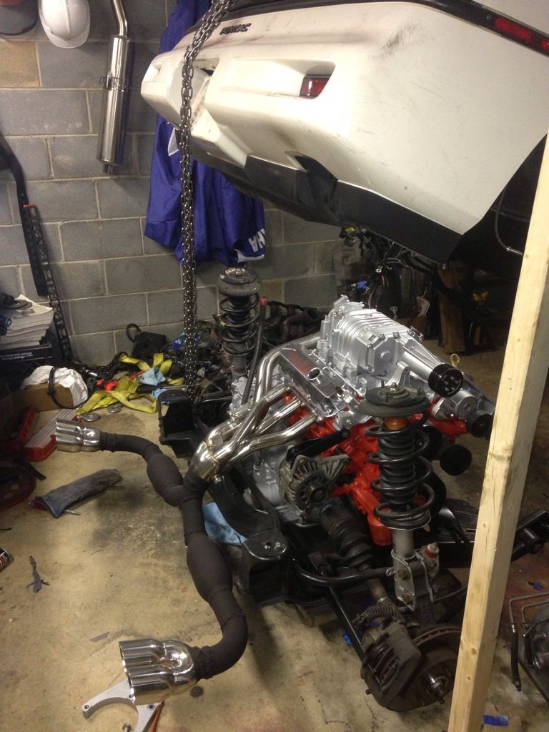

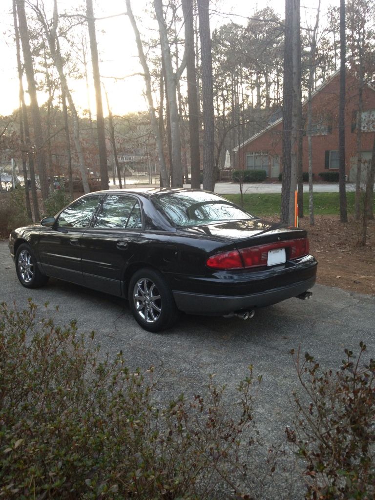

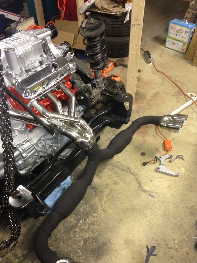

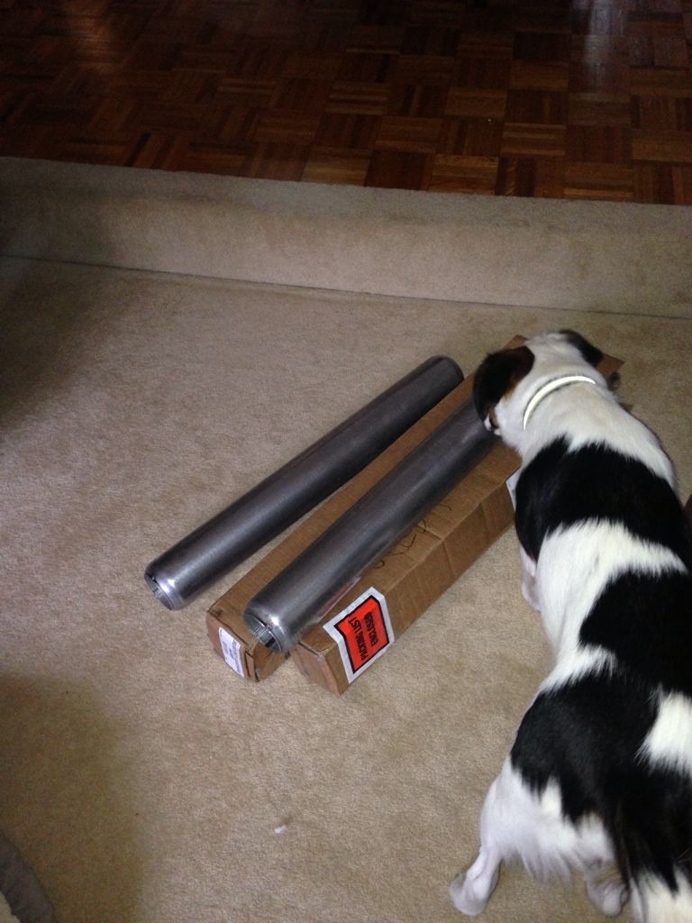

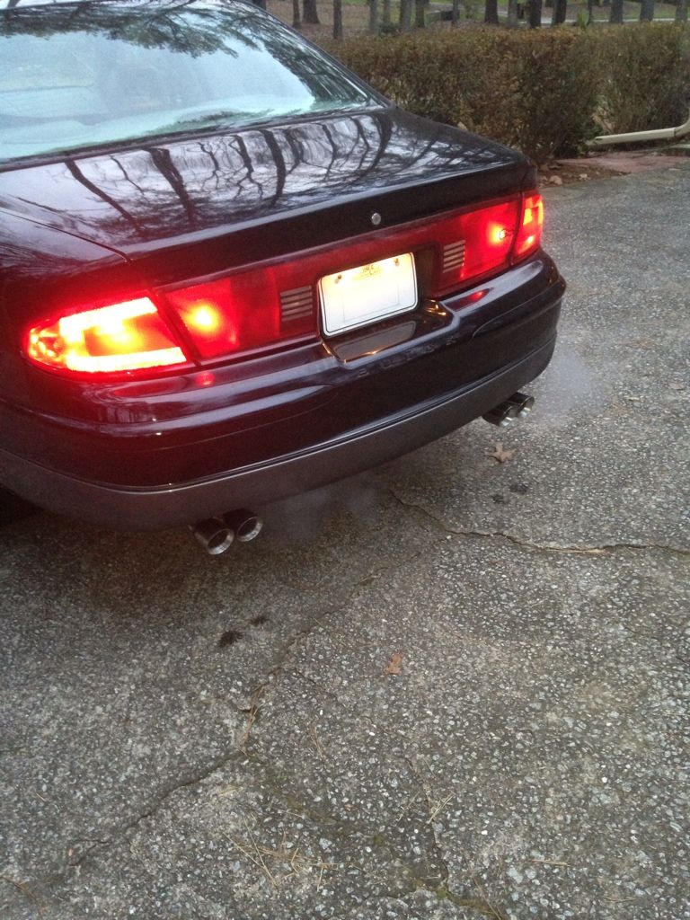

Today I have some updates for both cars! I finished the exhaust on the Regal yesterday. A little louder then I expected, but still very tame, especially at idle. It has a little bit of drone at 1300-1600 cruising rpm's, but only under load like going uphill, it is very tolerable. I still haven't really gotten a video of it from WOT on the outside, but it will come soon! The exhaust is as follows: speed daddy headers, 3" down pipe, 3" race cat, 3"x30" louvered glasspack (not cheap perforated style), from there 3" back to Y pipe split to dual 2.5", two 2.5" in/out Thrush Turbo mufflers, then dual 3" outlet C6 Corvette exhaust tips.
Summit messed up somehow and sent me two glasspacks even though I only ordered one!

All welded up and painted with header paint, ready for final install.
http://i1352.photobucket.com/albums/...ps09820b6a.jpg
Installed
http://i1352.photobucket.com/albums/...ps1ad8033b.jpg

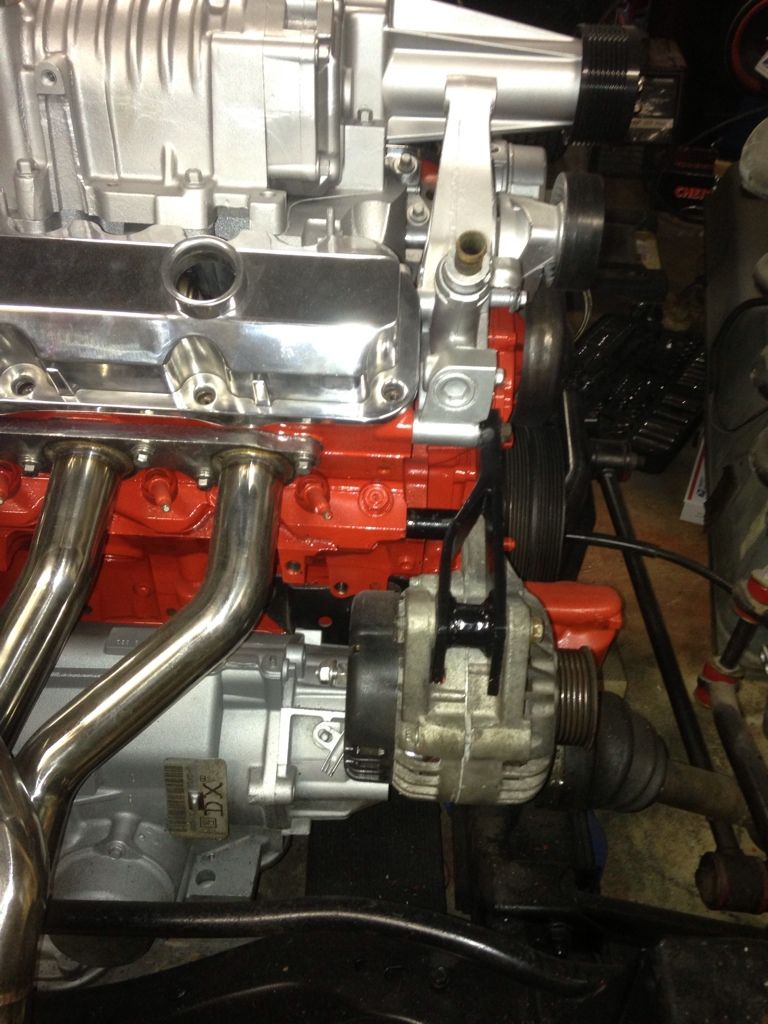

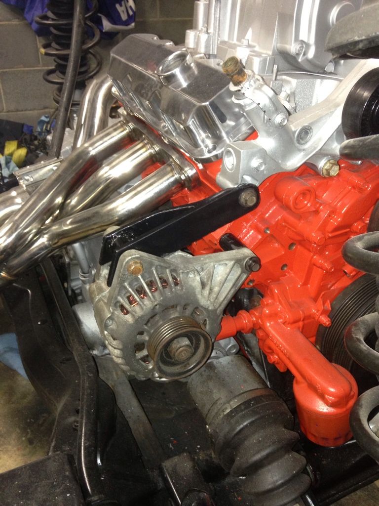

I went ahead and ordered a low mount alternator setup from someone on the Fiero forums, after I had emailed him for a little while we agreed that he would send it to me free of charge and he payed shipping, then I would give him pictures of it on the pretty motor along with a positive review for a promotional deal. I got that a couple days ago, here are the pics. Still waiting for my fuel rails, and plug wires to get here that I purchased from someone demodding there turbo car on the forums.. Then it will be time to put it back together!
http://i1352.photobucket.com/albums/...ps4d9c7709.jpg
http://i1352.photobucket.com/albums/...psdc03edc0.jpg
http://i1352.photobucket.com/albums/...psefeb709d.jpg
http://i1352.photobucket.com/albums/...psb501620e.jpg

Regal Exhaust sounds good at Idle and looks great too. Fine work Sir.

not bad at all. what mufflers did you use?
you also have 2 small bulbs out in the center tail light, lol
