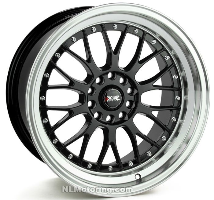

So this time around I want to get something with a little bit of a lip and maybe a gold face. I like the color now but i think the dark color makes them look smaller than they are. I liked the look of the xxr 521s (XXR Wheels: 521 18x10 Gold Rims) or something like that and I'm thinking the gold would be cool. And I'm also considering a slightly staggered set or getting spacers for the rear. Any thoughts on this you guys? And it would be awesome if you guys have some wheel suggestions.

I ordered these today
I think the gold face ones aren't made anymore, I couldn't find them. But I can always paint these.

18x10 +25
I already fudged up on tire sizes before and I'd hate to do it again. I was thinking of running a 225/45/18, any thoughts? (mainly for Bio)

i really think youd be okay with a 225/45/18. it's going to be a bigger stretch than you have now, but it'll still be enough tire to look good.
i wouldnt step down to a 215, though. i feel like that is too small. the overall diameter difference from stock to a 225/45/18 is about .5" difference...
Yeah i want to go with a slighty shorter tire with more stretch to tuck up into the fenders. Right now i have 225/50 on a 8.75 wheel and the stretch is almost unnoticabe and the edges of the tire rub everywere. I want to stay decently close to stock height just so my speedo isnt way off. And i actually think the tires I have now are a little taller than stock so plenty of the tire is tucked. So you think I should be safe with .5 inches shorter?
I ran some 245/40/18s for a while and my speeds wasn't off much
yeah, i'd go for the 225/45/18s. they should fit well with what you're doing.
