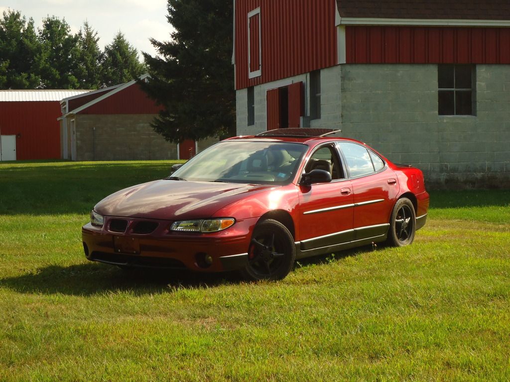

Its VHT and clear coats. I followed a writeup somewhere on here I think.

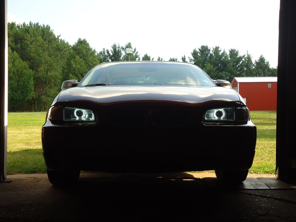

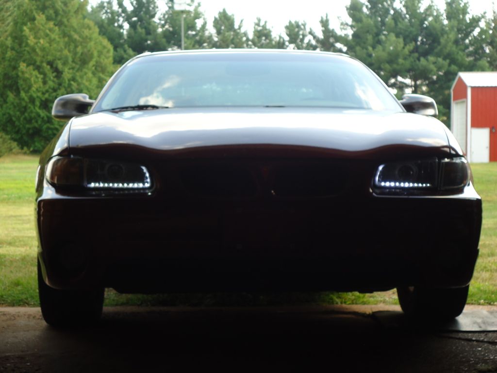

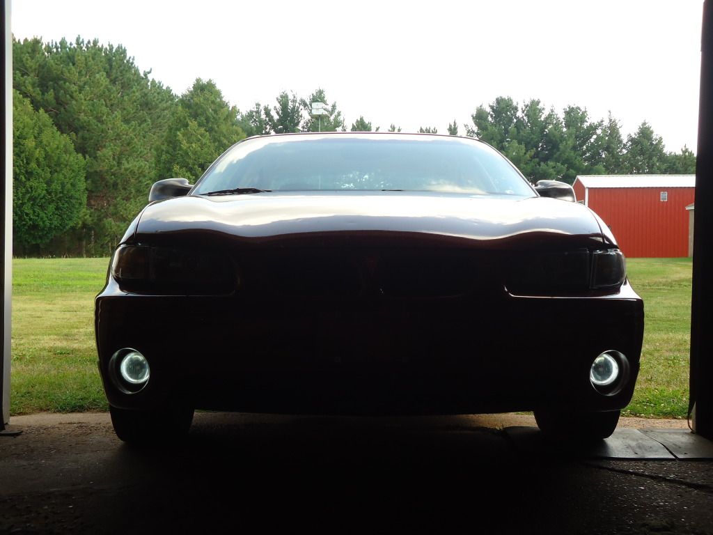

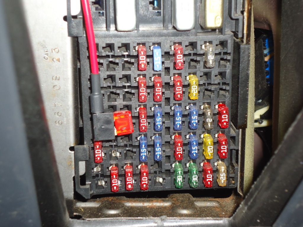

Okay so heres the project I did. I ordered a set of CCFL Halos for a Buick Lacrosse and the smaller one fit perfectly in the headlight and then the bigger one fit nicely in the foglight. I then put the leds in the headlights as well. The headlights were easy enough to get apart. Simple baking in the oven worked. However the foglights didnt come apart after baking so I took a hacksaw to them and got them opened up and put the rings in. It took a lot of drilling small holes in just the right spot so I could use small wire to hold them securely in place. Also had to drill holes to get the wires out. Took lots of RTV to cover the holes and such to prevent moisture from entering. The lights are wired so they shut off with the car so I dont have to worry about a dead battery. But anyway, heres the finished project!
Heres where I tapped into for power.

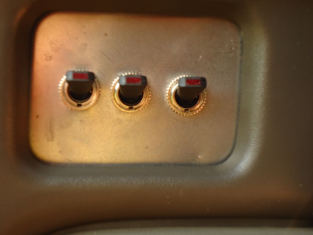

Three switches that I installed to control the lights. From left to right they are: Halo Rings in fog lights, Halo Rings in head lights, and LED strips in head lights.
http://i1137.photobucket.com/albums/...t/DSC01579.jpg
Heres the different ways I can run it down the road.
http://i1137.photobucket.com/albums/...t/DSC01572.jpg
http://i1137.photobucket.com/albums/...t/DSC01573.jpg
http://i1137.photobucket.com/albums/...t/DSC01574.jpg
http://i1137.photobucket.com/albums/...t/DSC01575.jpg
http://i1137.photobucket.com/albums/...t/DSC01576.jpg
http://i1137.photobucket.com/albums/...t/DSC01577.jpg

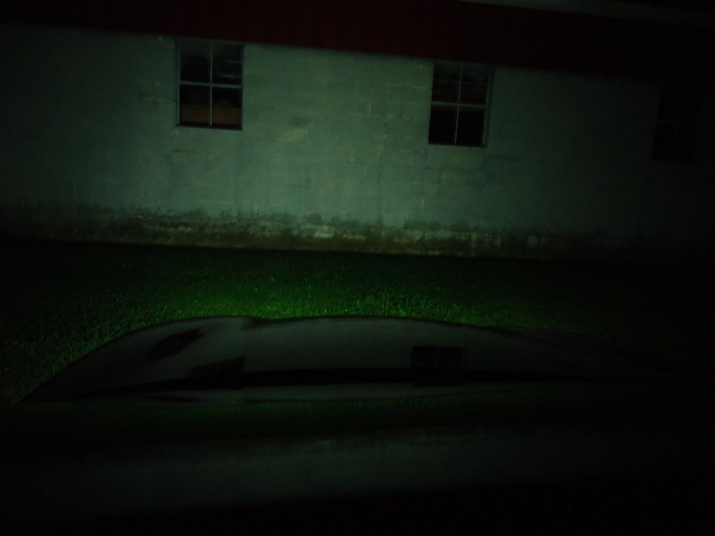

This is light output with all halos and leds on.
http://i1137.photobucket.com/albums/...t/DSC01550.jpg

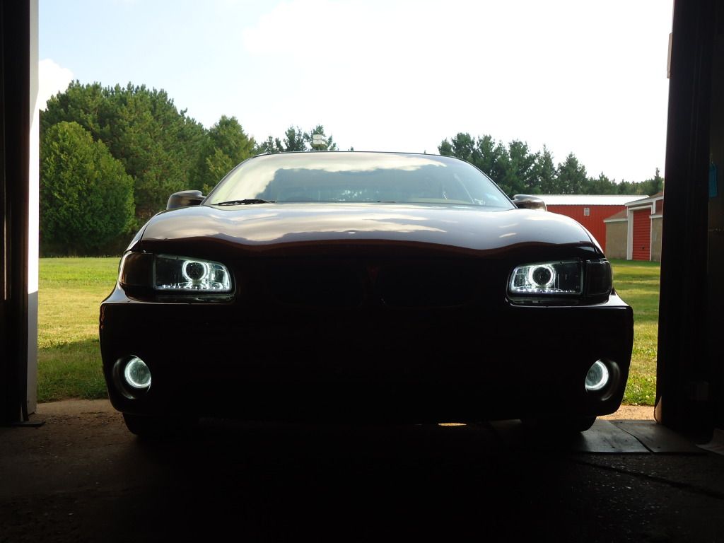

AND heres the most recent pic of the car with LEDs on.
http://i1137.photobucket.com/albums/...t/DSC01567.jpg
Not a fan of the Audi style LEDs in the headlights, but w/e. The halos on the other hand... NICE! Output is amazing too considering lol
The picture of the output may be a little misleading but they are pretty close to that. And the if figured since i was going to have it open why not put the LEDs in. lol. I rarely even have the LEDs on. The rings are on all the time pretty much. lol.

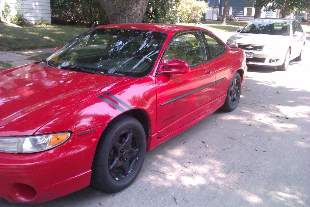

heres what my car looks like with stripes and door ding cover in plasti dip.
http://i1060.photobucket.com/albums/...9/740872db.jpg
Looking good buddy! :th_thumbsup-wink: Are you going to plasti dip anything else?
haha, not sure. i posted a ride thread and so far it seems like everyones raggin on my plasti-dip ideas.
