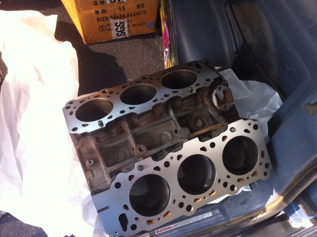

and then the engine that came with the "parts" car
http://i1091.photobucket.com/albums/...0/8402edd7.jpg
tore the engine down and had it machined
http://i1091.photobucket.com/albums/...0/a1a9c58e.jpg

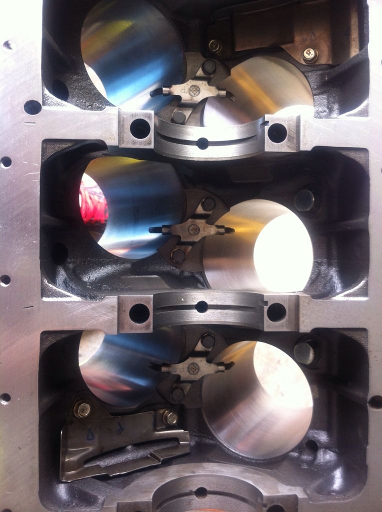

Honed cylinder walls
http://i1091.photobucket.com/albums/...7C20F717BB.jpg

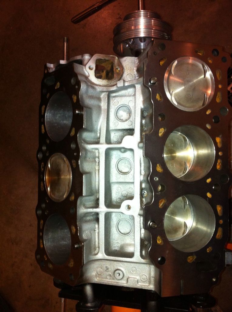

Pistons in
http://i1091.photobucket.com/albums/...psf23d5359.jpg

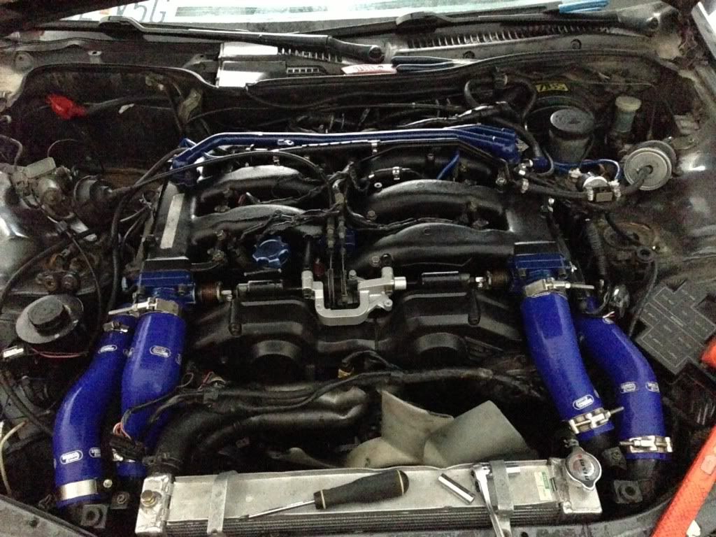

engine pretty much complete turbos strapped on aswell
http://i1091.photobucket.com/albums/...80585E1CF4.jpg

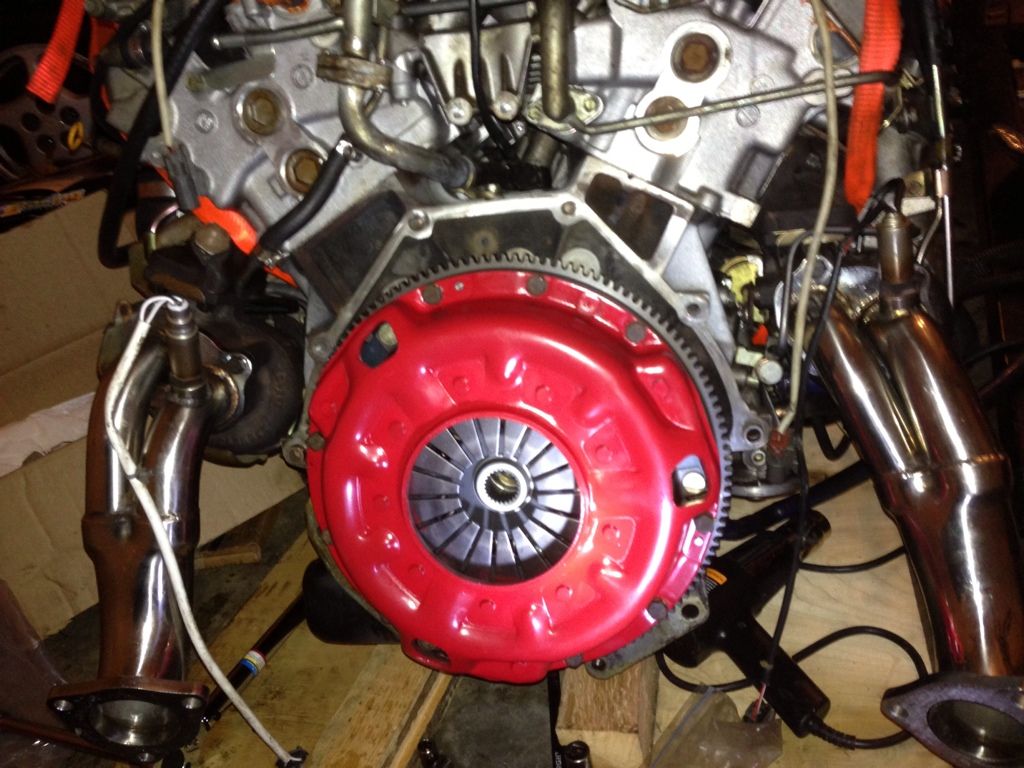

lightweight flywheel, heavy duty clutch, and divorced downpipes
http://i1091.photobucket.com/albums/...ps7aeb8ee1.jpg

FMIC shot, really coming together now
http://i1091.photobucket.com/albums/...psda5c324a.jpg

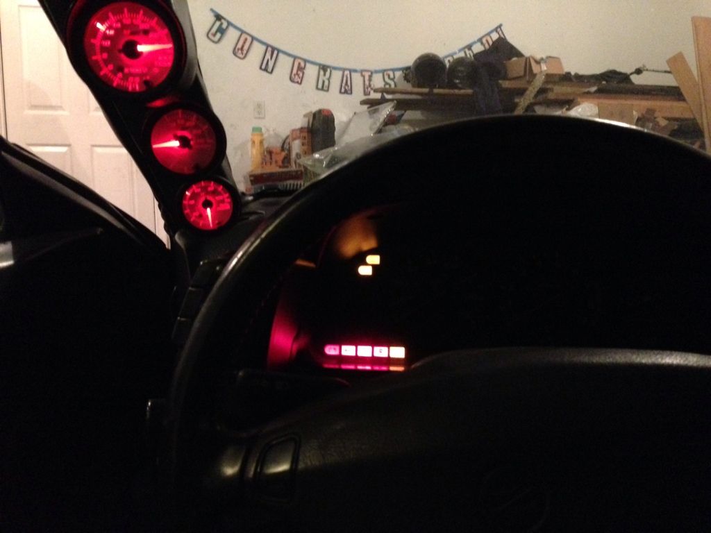

gauges and boost controller
http://i1091.photobucket.com/albums/...ps006763cc.jpg
http://i1091.photobucket.com/albums/...ps13a99531.jpg

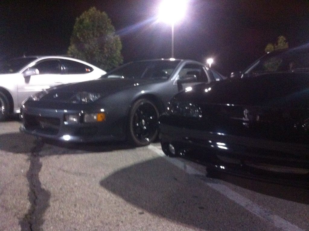

pictures of the car body i actually used
http://i1091.photobucket.com/albums/...0/d173ac3c.jpg
http://i1091.photobucket.com/albums/...0/a9b89c11.jpg
http://i1091.photobucket.com/albums/...0/21d8dfe6.jpg
http://i1091.photobucket.com/albums/...0/64f1886e.jpg
lol @ this GP
http://i1091.photobucket.com/albums/...0/837364bc.jpg
http://i1091.photobucket.com/albums/...0/144a78de.jpg
I ditched the black wheels because im hoping for 475rwhp on 19~20 pounds of boost, not much sense running around on 225s LMAO
i also ditched the body kit, and am in the process of cleaning it up a bit, just have to finish braking in the engine first.
