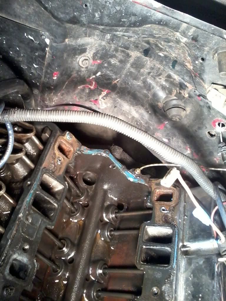

oh yeah, it was a pretty good day off.
http://i1001.photobucket.com/albums/.../Photo0238.jpg
the black spot in the back? that's not a shadow...

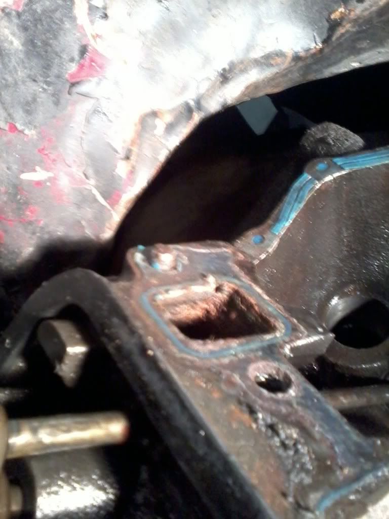

http://i1001.photobucket.com/albums/.../Photo0239.jpg
and possibly why it was leaking...

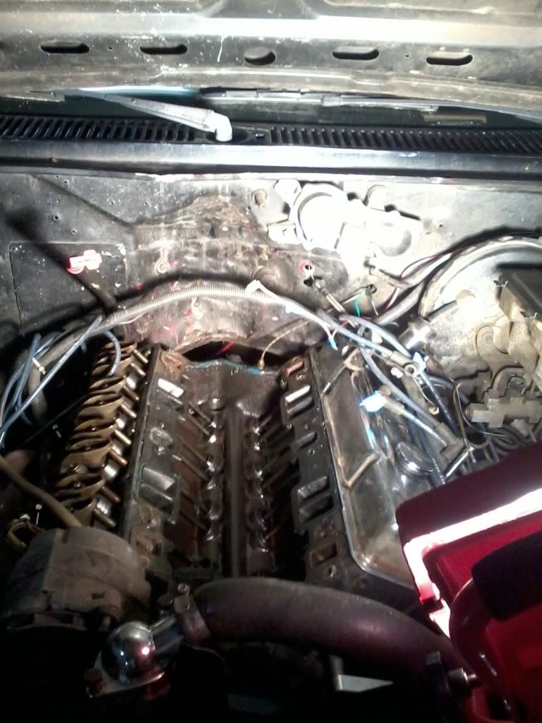

http://i1001.photobucket.com/albums/.../Photo0240.jpg
maybe not, because it was a lot more prevalent on the right side. going from the transmission and the fact that i watched it drip from the right side, it might not be an issue. i don't have an tools to get it out, i might just have to get crafty with the RTV. where do i get this Right Stuff that you're talking about?
Re: phil's smallblock s-dime
Ouch. I'd definitely work on getting that bolt out. If the gasket doesn't seal there, you could have coolant leaking into your oil and not know until it's too late. Right stuff should be at any parts store by the other RTV's.
yeah, that's a good point. i don't really have a drill that can get at it though...
Soak it with penetrating oil for a few days and try vise grips. Maybe you could borrow a 90 degree drill or get a cheap one from harbor freight if you can't get it out.
