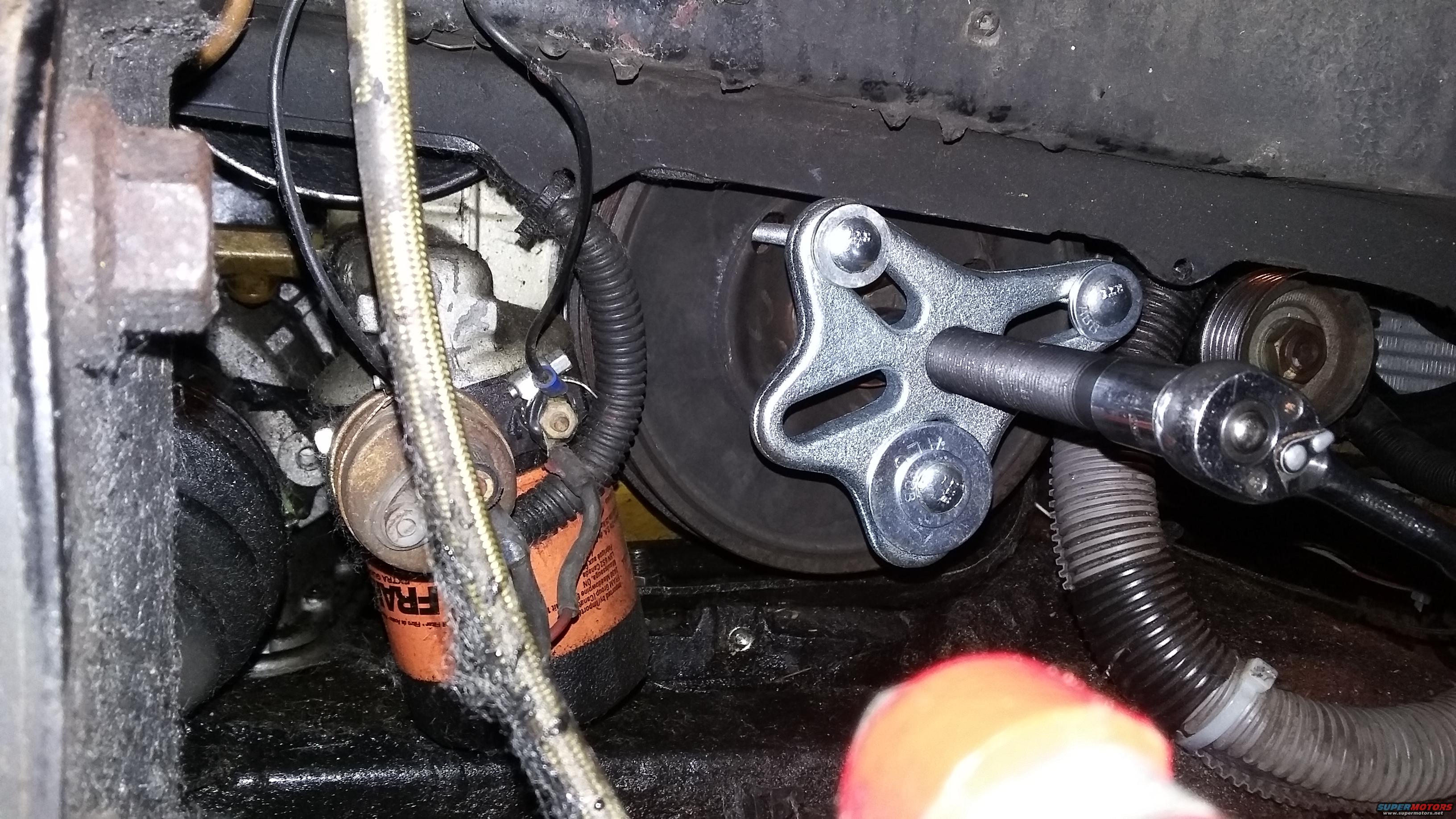

Time for an update. Blue Turbo hasn't ran since June 12th. It will not start, no matter what. I have been visiting family in Poland and just getting back now so didn't mess with it too much. It has no codes, no nothing. Just cranks, and cranks and sputters for 1sec. and nothing. Dies. Fuel pump primes. No security light, etc, etc. Now, I have 2 dead GP's in my drive way. Sucks. Before I left I replaced the crank sensor. Didn't help with nothing.
I'm thinking to put engine/Trans in maroon GTP, and scrap the shell of blue car. The body and rust situation is much worse on blue car, so it would be the one to go. Plus I need 4 doors. I really just want a car that runs! WTF, these damn GP's.
Only have 1 photo of the sensor removal for some reason, although I know I took more....

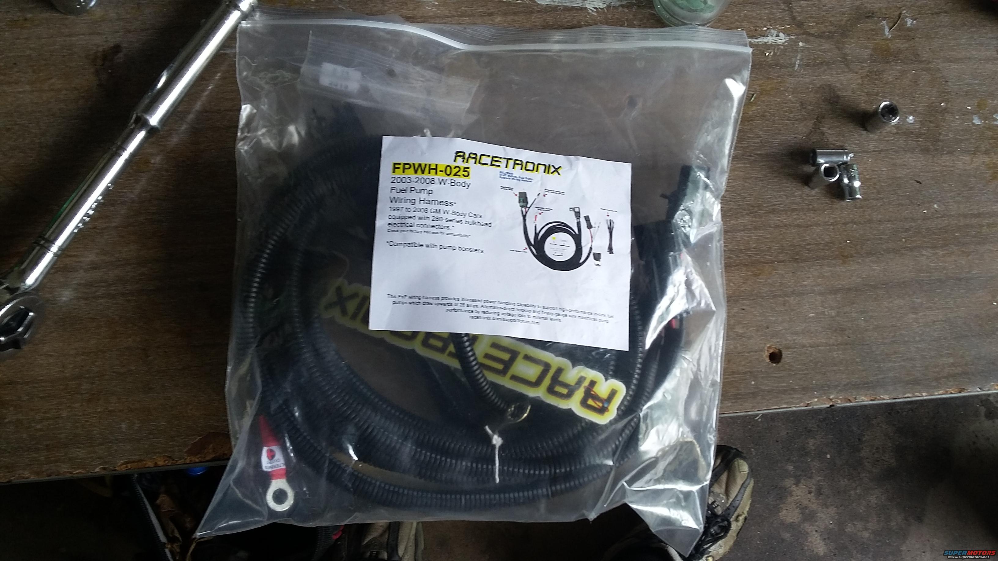

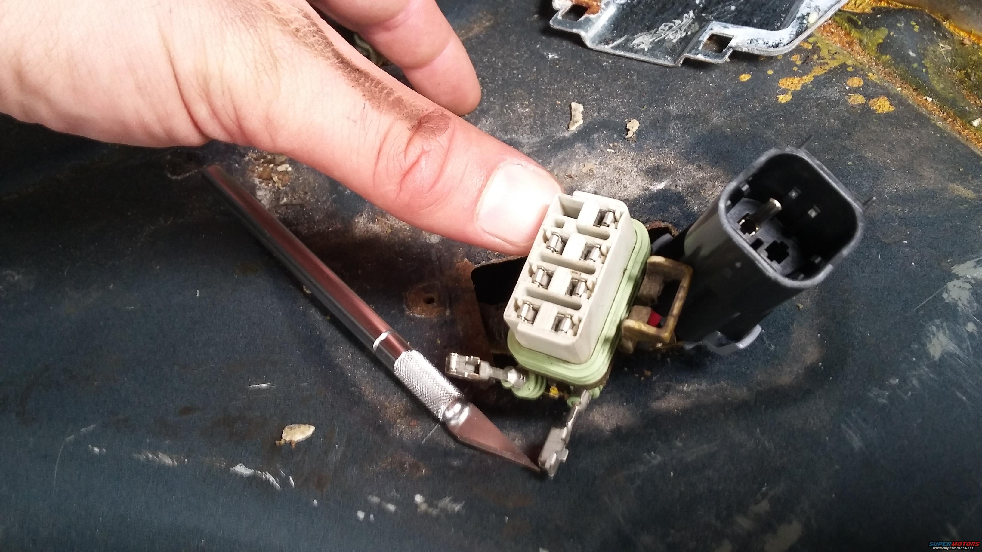

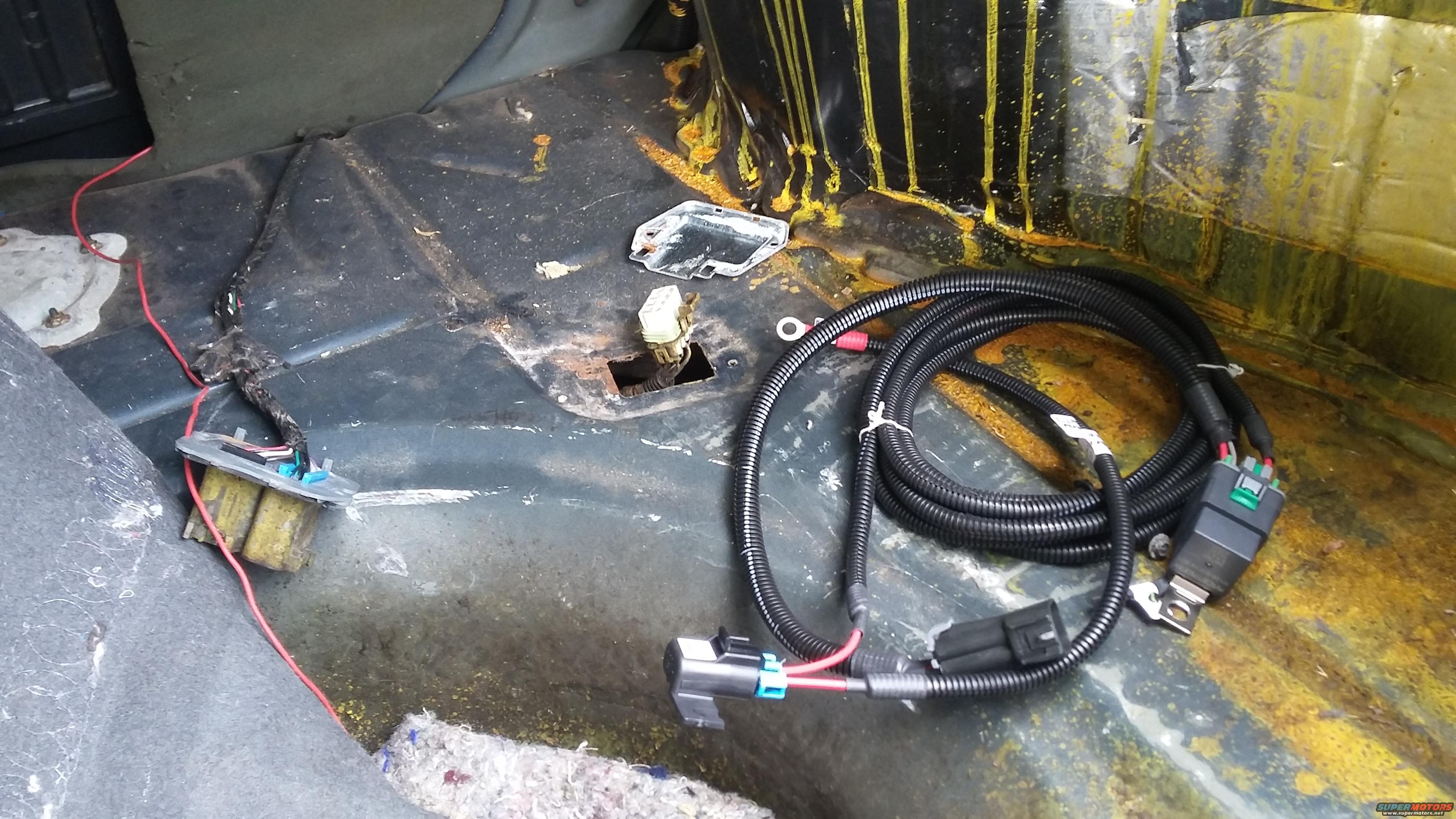

Fuel pump re-wire went in yesterday. Car already had the Caspers in place, but not wired up becuase it requires an all stock harness to work. The harness the car has now, like most, was hacked for an aftermarket fuel pump. I went ahead and spent the coin on a RaceTronix rewire kit and installed that. Hardest part was un-clipping the wire connectors with the Exacto. Routing it under the car took some time as well. I ended up tucking the wire/loom into the plastic ground effects along the passenger side, and using zip ties. Worked out great.
Only took a few photos:
