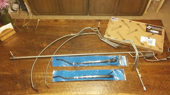

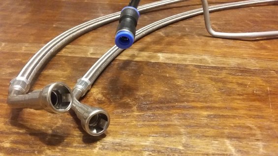

Got all the goodies I ordered on Black Friday. Not my exact wishlist, but almost: Fuel Lines, Wiper Arms, SecondSkin Damplifier. I can now finish up insulating the car, and finish insulating the door panels. Got a box of new door pins as well. I was gonna sand and repaint the wiper arms but forget that. Other then being worn down looking, the plumbing on them sucked, so for about $16ea. on RockAuto, why not buy new ones? Fuel lines came all the way from New Brunswick, free shipping too. RockAuto wanted $55 for shipping... pshhhh
I was gonna take the fuel lines to a shop to get installed but I'm thinking that doesn't get much approval around here. They are just plug and play, right? Any pointers are appreciated.

I had those wiper arms and they start to rust pretty quickly I was pissed. Might want to paint them with some black restolium anyways.
Fuel line wise
1. tape all ends tight so NOTHING gets inside
2. Under neath the car is pretty straight forward and easy as hell to do, the bend area by the firewall gets tricky. Im talking twisting turning the line every which way and it still wont go 100% in, but will once you revert back to test #2 after you tried it 30 other ways. I found it easiest to feed the flex line up first and try to get the rest to follow, now if you want to remove some parts, strut, axle, anything else you deem fit I bet it would be alot easier to snake it in;)
Thanks for the tip! Definitely not looking to buy another pair anytime soon. I'll spray them down a couple of times.
LOL! It's going to be a frustrating few hours of trial and error. I'll try snaking them through the bottom like you said, hopefully the bends are accurate. They will be getting replaced soon, between today and Christmas... there's time to watch a few videos.

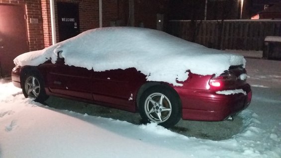

Well.... took the old girl in for some hibernation. With all the cold and snow if the forecast, there is no way I am wrenching anything, anytime soon. We got about 6-7 inches last weekend, and then arctic air. The forecast for this weekend calls for another 6-7 inches and wind-chills at -15 to-25 below. No reason to punish myself and work outside. Also, with the holidays approaching, I'm not likely to find anytime to work on it anyway. This all started working curb-side in the city, then moved it to the back of my sisters store. Did a lot of work on it there and that's where it has sat. But with winter here I wanted to move it somewhere more hospitable. Luckily, my mom has a nice place with a heated basement garage. She has 2 spots and only 1 car, so the GTP will rest in the second spot until the weather breaks and I have more time. Good ol' mom. Always coming through.
Back of sisters store. Drivers side is on ramps. Covered in snow:

In its new resting spot. Till it's at least 30*+ outside:
http://www.supermotors.net/getfile/1...ullsize/03.jpg

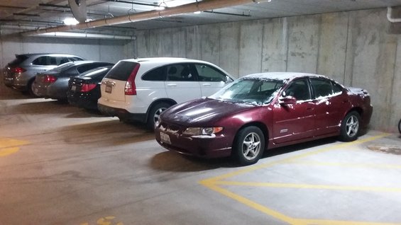

The warm weather never really came... So, like many dad's before me, I packed up the car, and wife and kids, and went on vacation. Drove from Chicago to Key West, almost the entire height of the country, some 3,500 miles total, round trip. We split the driving duties. Spent some $300+ in gas which isn't much.
Before kids and wife, I did some serious road trips in my then 2001 Accord Coupe. One time, in 2009, I drove from Las Vegas to Chicago, straight, non-stop, no sleeping. Running on Coca-Cola and Twix. One buddy didn't have a license, the other was deathly ill. It was 30hrs of non-stop driving. Stopped only for gas and once for McDonald's, which we ate in the car. lol. Anyone beating 30hrs?

Leaving Key West:

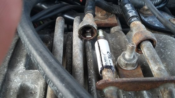

Weather wasn't too bad today so I got some wrenching in. Started on getting the old fuel lines out. I read a thread on here earlier this week where someone said to use the cap from a Sharpie to disconnect the fuel lines. I remebered that, tried it, and it worked, kinda. The cap proved to be too flimsy, so I ended up cutting the Sharpie marker apart, then used the gray plastic part of it. Worked great. After that lucky break, I was pretty much stuck. Two of the three fuel line connectors were seized and would not budge. I tried tapping them, spraying them, going ape on them, and nothing. I'm thinking I will have to cut the Nylon lines and buy a fix-kit. The place I got my fuel lines from sells a kit. Not sure though...
Link to kit:
http://www.linestogo.com/nylon-line-...FdgMgQodmAYEaA
Any thought's or suggestions about loosening seized plastic?

Sharpie releasing the smaller fuel line:
For the larger fuel line, I doubled-up the cap and the gray piece to make it thicker. Worked like a charm:
http://www.supermotors.net/getfile/1...ullsize/04.jpg

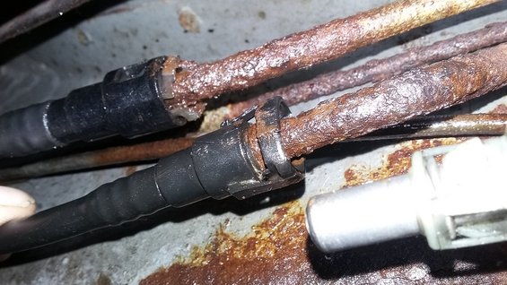

Top line is Return Line, fitting is seized and line is rusted solid. Middle is EVAP, also seized/rusted. Only the fuel filter fitting came off. Gonna have to snip:
http://www.supermotors.net/getfile/1...ullsize/06.jpg
