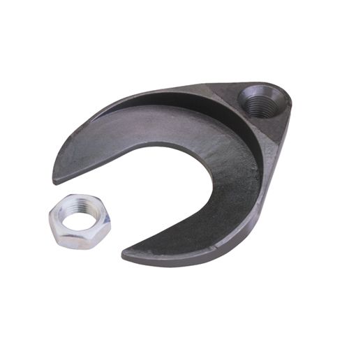

Also thinking I can take some flat stock, weld up something like this to use with my slide hammer:
http://s.shld.net/is/image/Sears/009...sm=0.9,0.5,0,0
3 pieces of flat stock welded in a U shape with a nut welded on the end, looks pretty simple.

You doing the driver or passenger side? If you use that tool and a slide hammer on the paasenger side, you are making it harder on yourself. Crawl under and whack it from behind. It's super super eaaaassssy.
