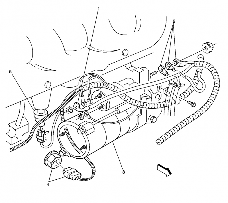

    26,833
    If wiring is a question.. Here's the diagram. Can't believe Scott didn't post it for you.
