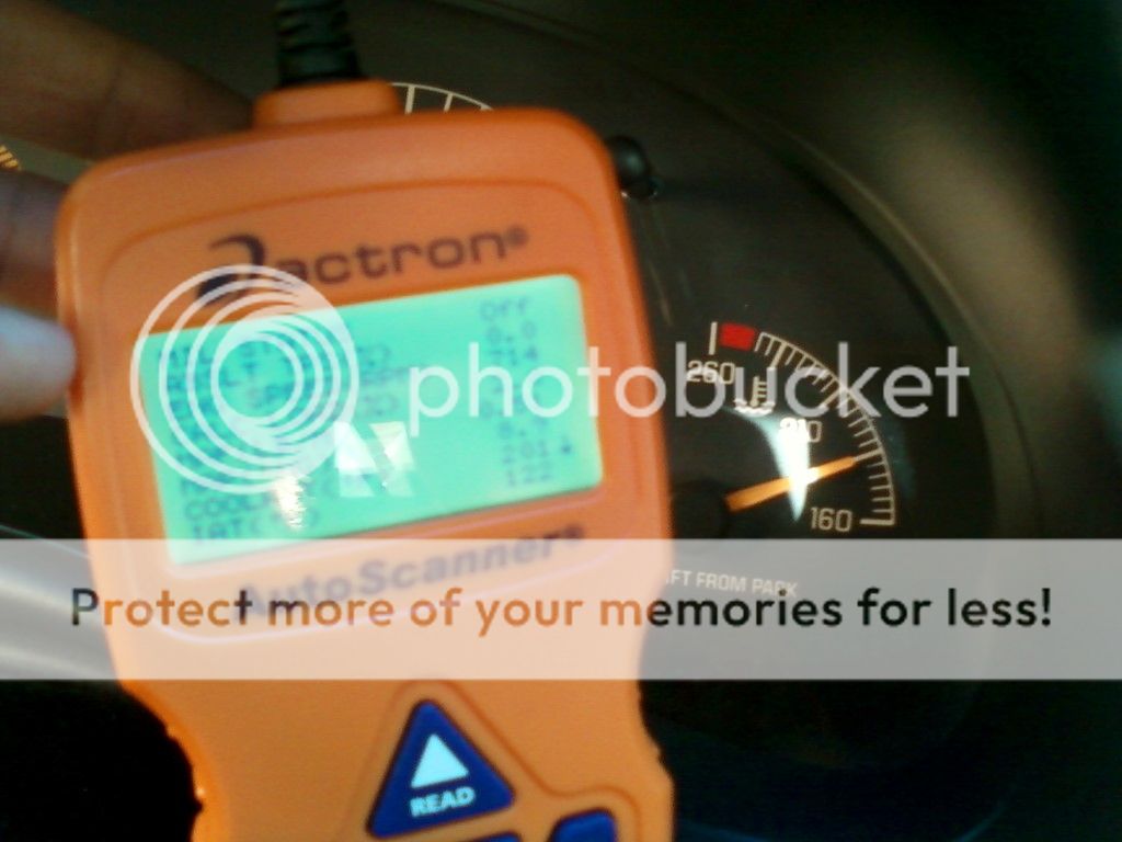

    This is normal for cool to cold climates. It is 200° believe it or not, the gauge is not incrementally equal if that makes sense.
    Should get there within 10-15 minutes if it's around 50° out or warmer.
    Here's a cool pic I took a while back. Proves that line is 200°. The actron scan tool shows 201° and the gauge is pretty much right on the second line, if not slightly above due to it being 201 and not 200

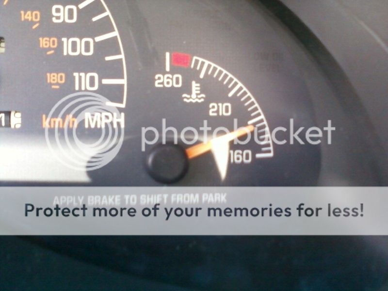

    02NavyBlue - That's where my car always used to operate. I just took the car for a 5 minute ride,a bout 30 degrees out and this is where the temp gage is at now after replacing the coolant temp sensor.

    That is a bit high, that's probably like 220-225° I'm not sure that's correct. The previous sensor reading is what I'd consider normal. Either the new sensor is reading wrong, or (unlikely) the old sensor was incorrect, and the new sensor shows you're running a bit too hot.
