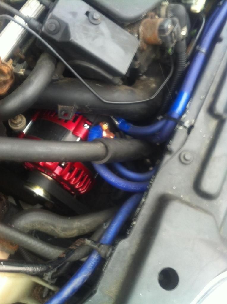

u should be doing the big 3 to take advantage of the upgraded wire that means pos on alt to batt... eng block to chasis for ground I used the alt bolt and ran 5 inches to firewall and also from ground on batt to body I simply jus overlapped all stock wiring with 0 gauge you cant go wrong just make sure you do the grounds aswell

Re: 1/0 gauge wire and high output alternator Question.
Did you scratch the paint off where you grounded it to the strut towers? It won't ground very well with the paint
Yea....I sanded it down to the metal.

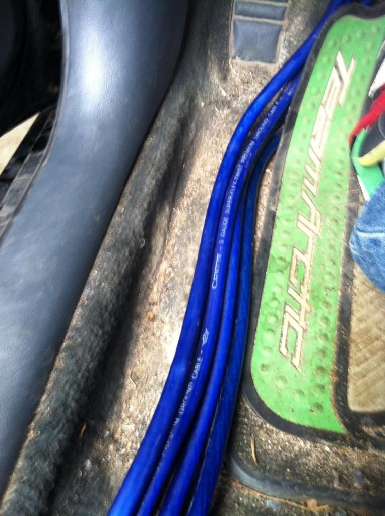

ull be fine with that specaily for that 160 amp alt im runnin a mechman 260amp alt and 1 run of zero with second batt and I clamped the wire and was pullin 240 single run, will pull fine remember alt only generates amps when its under load so.. ur good to go, (cant argue thou more runs are better)I got an 18 inch soundqubed walled in my 04 and they said that cant be done!
Well, I'm glad to here this. If I put a bad ass system in my ride I will upgrade, but at the moment that's not my main concern.
