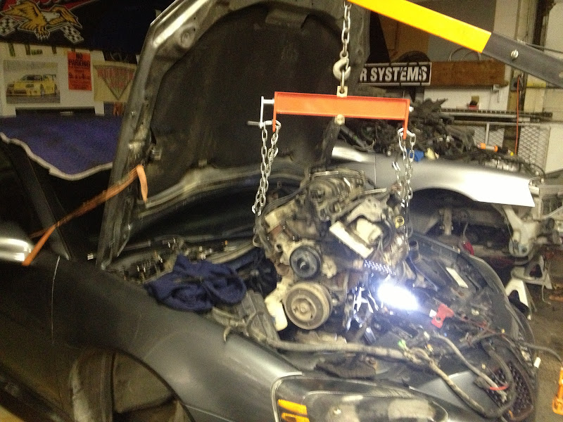

Big progress last night on the car.
I pulled the GT's motor, and started cleaning up the engine bay. It's pretty nasty so I decided to let it soak overnight.

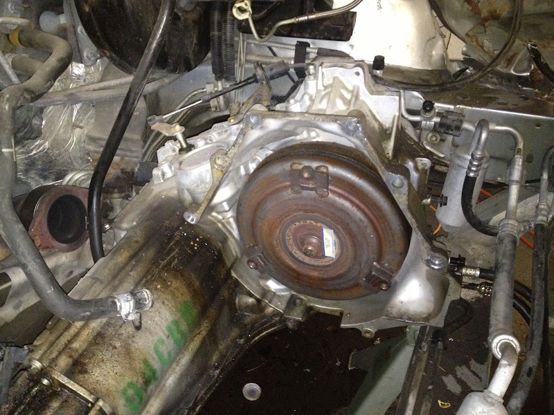

I'm pretty sure I'm going to be swapping the CompG transmission into the GT. I looked at the markings on it, and they match up with the GM rebuilds I found online. It isn't too much more work to make the swap now, since the engine's already out of the way!
My Trans:
https://lh3.googleusercontent.com/-7...0/IMG_2970.JPG
https://lh4.googleusercontent.com/-l...0/IMG_2978.JPG
https://lh6.googleusercontent.com/-I...0/IMG_2979.JPG
https://lh6.googleusercontent.com/-E...0/IMG_2980.JPG
https://lh4.googleusercontent.com/-o...0/IMG_2984.JPG

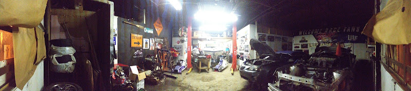

Just for fun, a panorama shot of my work space.
https://lh6.googleusercontent.com/-p...0/IMG_3018.JPG

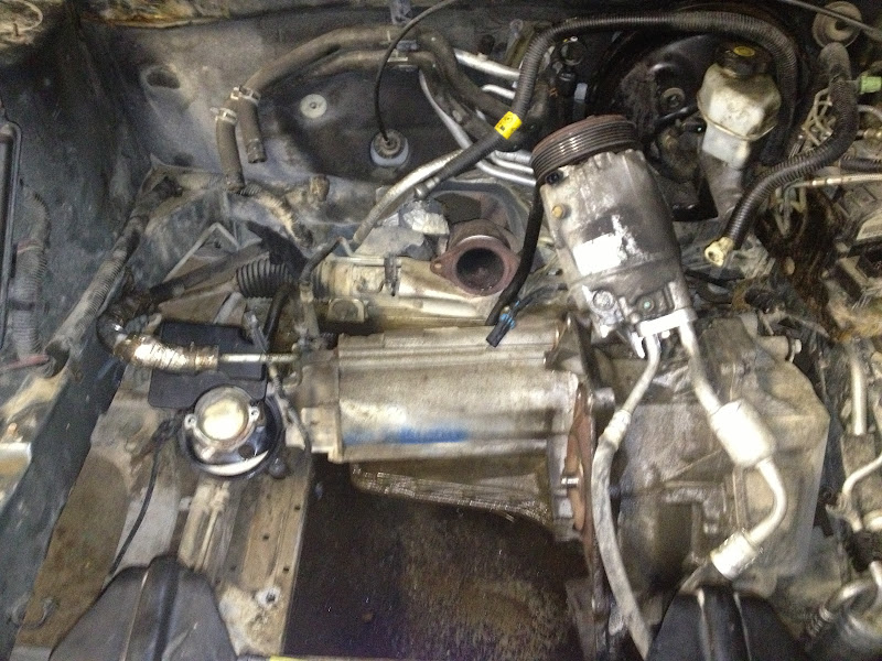

More progress to report, but not as much as I hoped.
Both subframes are out, transmissions on the bench. I went to swap the channel plates, and ran into a little snag. The 4th gear clutch packs are different between the CompG and non-CompG transmissions, and don't fit under the GT's channel plate. I was going to re-use the original GT clutches, but they're shot. A new pack is on order from Dave at TEP.
Other then that, I've gone through and verified almost all the wiring changes between the CompG and GT engine harnesses. Most are for the stabilitrack system, the additional ambient pressure sensor, and the boost control solenoid. I still need to track down 3 pins on the ABS connector, but I don't expect them to cause me an issue.
Started cleaning up the GT's subframe for reassembly in the car, as soon as my transmission parts arrive I'm going to start getting this thing back together!
