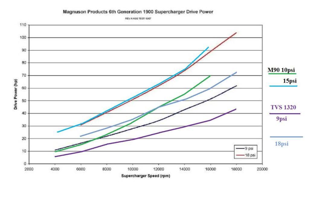

someone on club gp posted this link
A snap shot of Eaton’s superchargers | Supercharger Performance and Engine Performance Parts
with headroom 150hp higher than the m90 why would u need the added drag of a 1900? the line u drew on the 1900 would have it running like a 5 inch pulley lol
also this is worth taking a look at
http://i201.photobucket.com/albums/a...DrivePower.jpg
3.4 on the M90.
3.2 on the 1320.
3.9 on the 1900.
Rated HP means nothing when you have the performance map which clearly states that if you were to push the blower any further than what I showed, you'd fall outside of the magical 70% AE.
Yet a 1900 would still be >70% for some time to come.

Edit: Hell lets use your chart.
R1320 14 300 RPM for 1080 m^3/hr at a 1.8 PR.
R1900 10 500 RPM for 1080 m^3/hr at a 1.8 PR.
1320 uses 30 HP.
So does the 1900....
Hmm...
