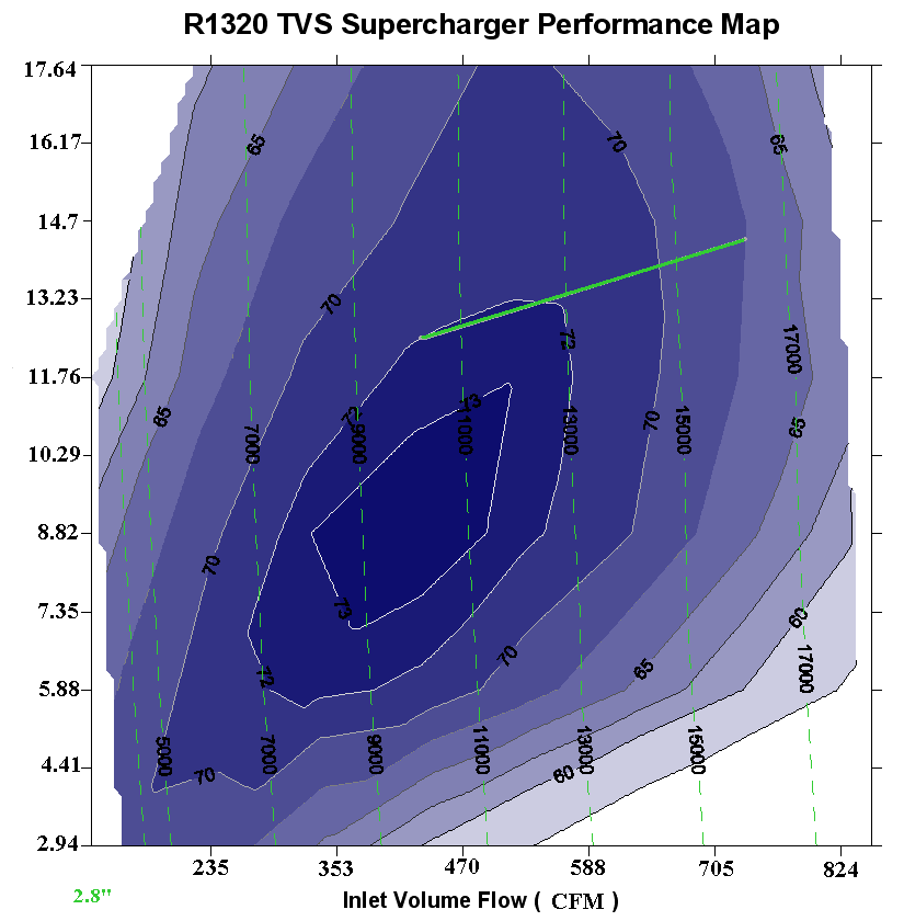

This is where I'm at right now on the 2.8''

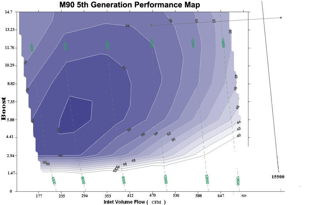

People routinely do this to the m90, 2.7 pulley...
http://i201.photobucket.com/albums/a.../ct_128485.gif
What's the efficiency out there in no mans land??? 35%?

Everything is great about the M90 except its performance.

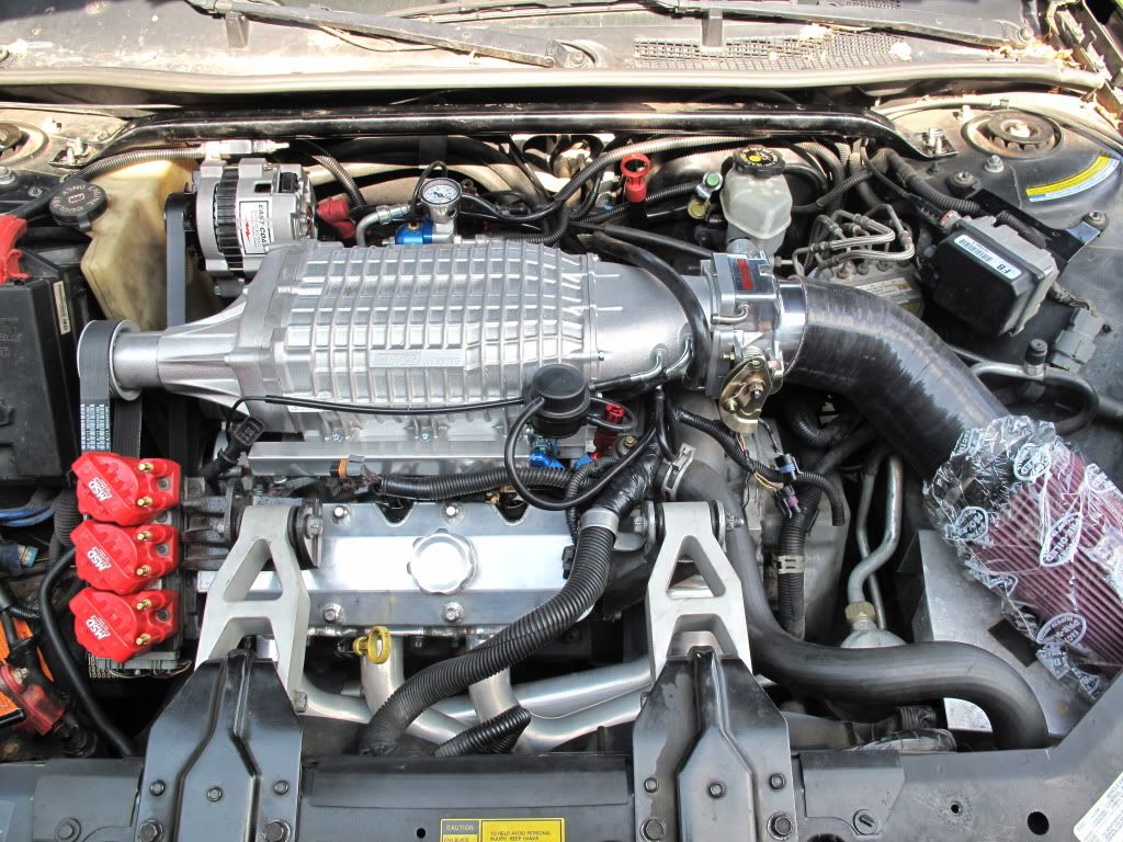

just remind me was he intercooled before?
if so how is hood clearance w/ the adapter plate?

i wouldnt mind this swap if there werent so many other options given that you had the ability to make an adapter for around the same prices. honestly, i want to see more of the blower swap situation. i love the blower swap more than a turbo setup in any shape or form. it will always suit the car better and given that you can get the right setup with the right blower it will always impress me.
i want someone to hook up a kenne bell. ;)

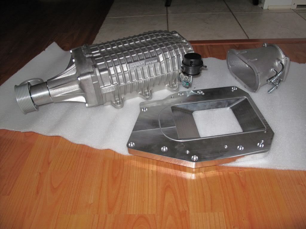

I believe that's an M112 off of a Cobra/Lightning redline

hmm its the one of the GT40 the thread said
damn that 1900 is badass looking

That 1900 kit will cost you quite a bit.
Got the bill...
It was a little more than I expected: $4003 AUD including freight and 2 pulleys
That's about $2800 us.
The wife's going to be pissed

You mean GT lol...M122 instead of the M112 ;)

it's still one sexy ass blower tho
